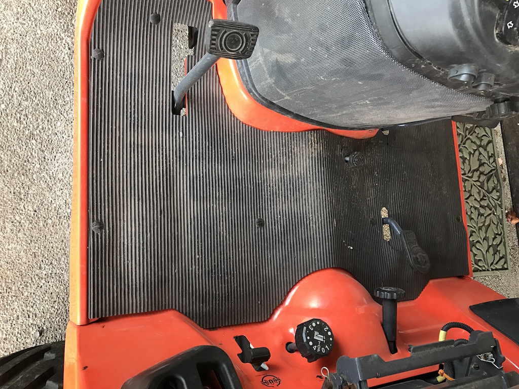

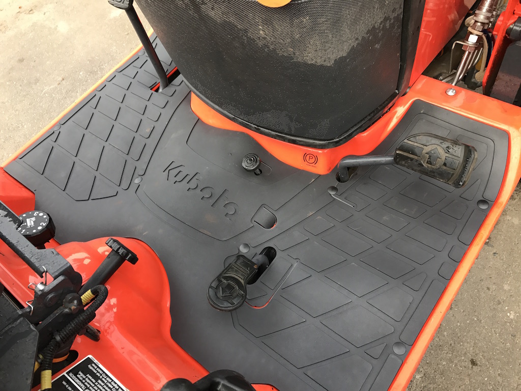

Decided to give my BX a little spruce up after 330hrs of abuse. Try to treat her special so she stays around.:D

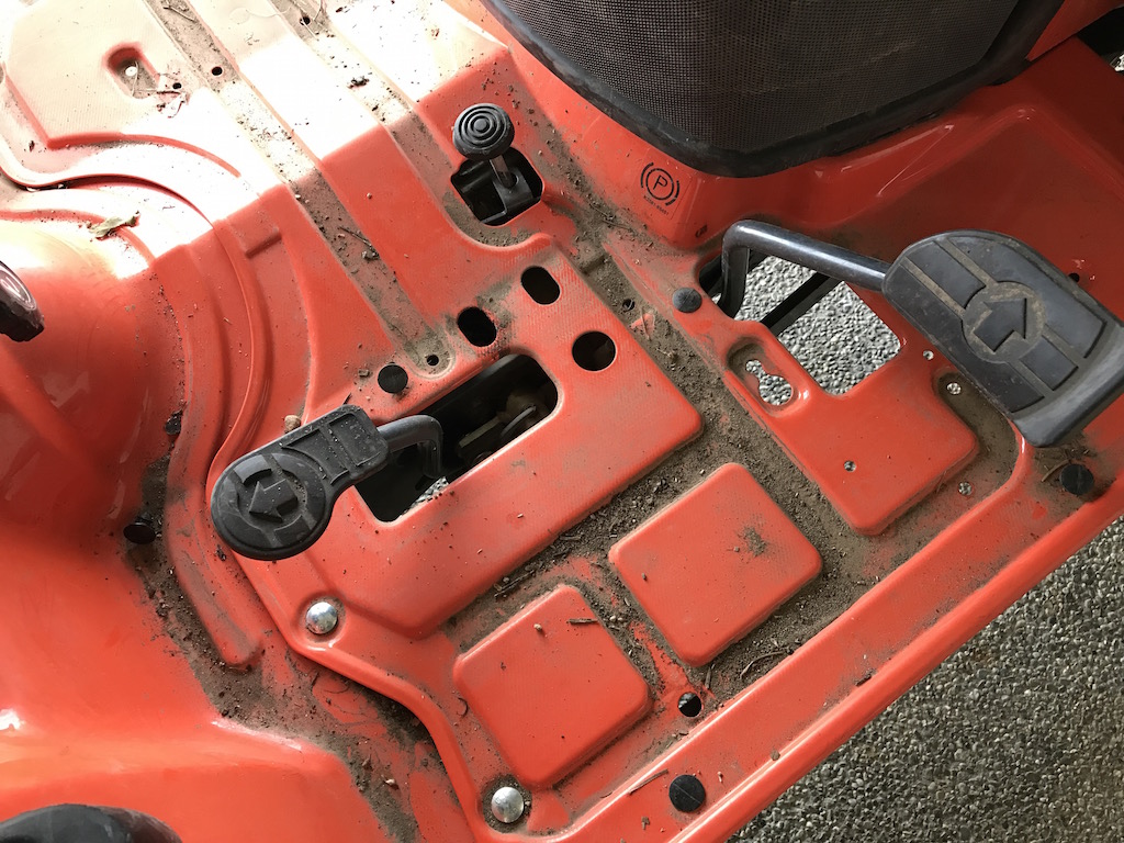

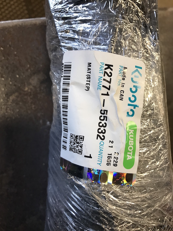

Replaced the original floor mat with the latest version. Much thicker is the new one. Here is before and after pics. Did also buy new push pins for securing it as the old ones were pretty much destroyed on removal of the old mat. Cleaned up underneath... surprised how much debris was trapped. Pic was after blowing off with air and before pressure wash. See p/n if you are interested.

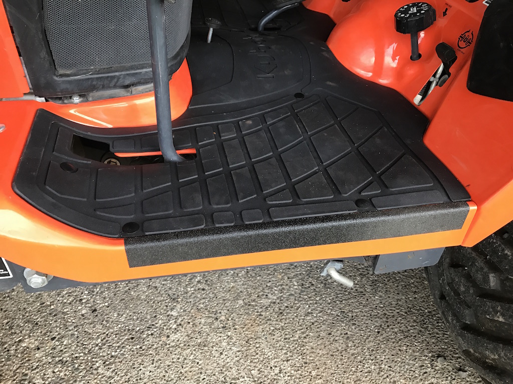

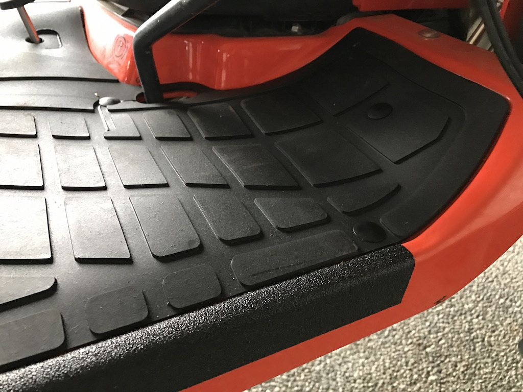

Liking the mat but one thing it didn't solve even though it is thicker... is the possibility of slipping on the corners when climbing on/off. I have slipped a couple times stepping aboard in the past. So... today I put some anti-slip take on the side. Big improvement!
   / BX floor mat replacement #4
Good mod. I like the new mat look and the non-slip idea is good too
