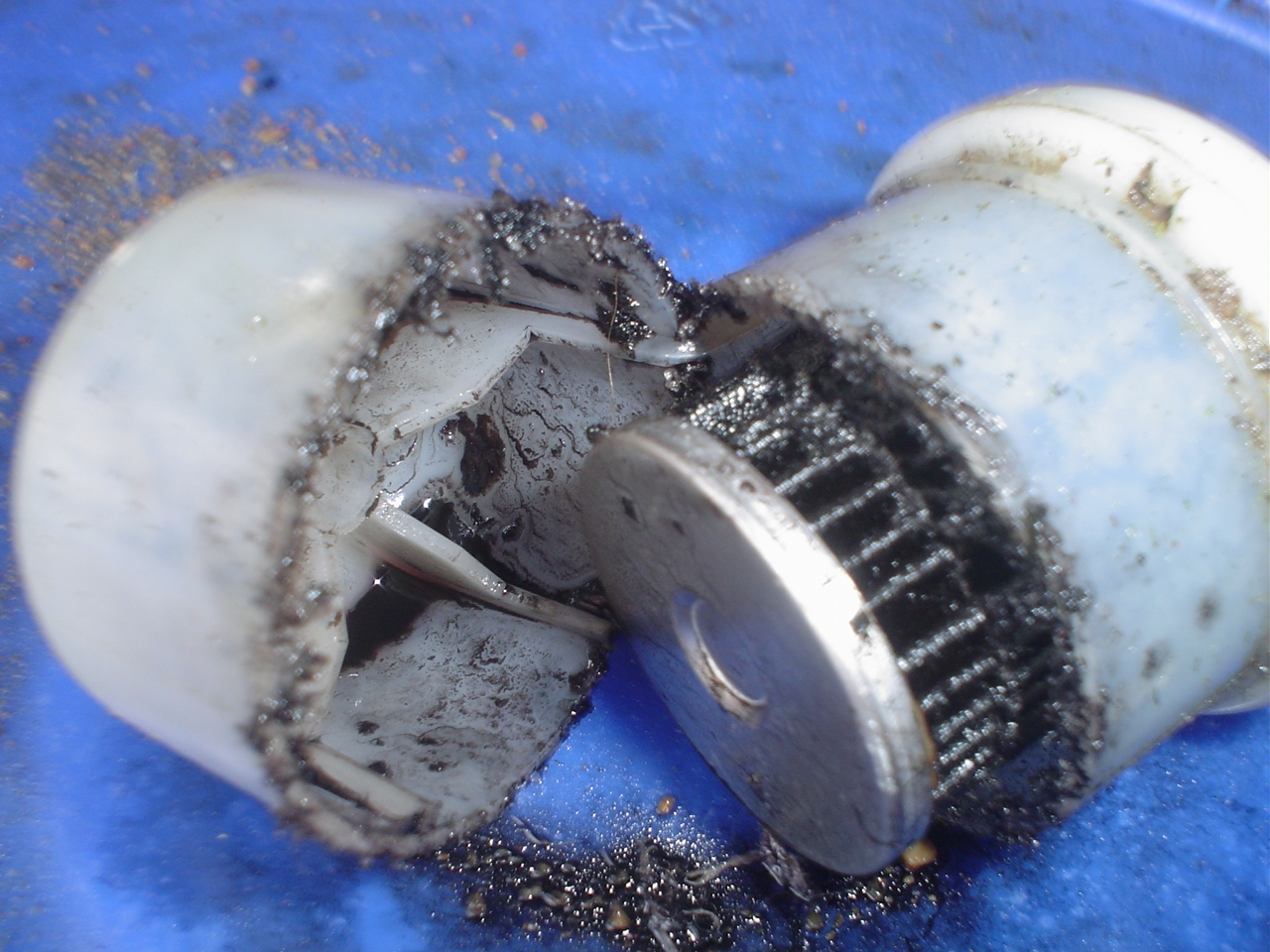

Here is a photo of my primary filter (471 hrs) taken off my 2200. I don't recommend going this long (even though the maintenance schedule says check every 100 or change every 500 hours). While I had no significant "sputtering issues", I did not notice how much power was being robbed until after I changed out the filters... what a difference! So, for all the wondering fuel filter changing folks, I'd say do it twice as often as recommended, just to keep your power up for those yard projects!.

Good post. That filter is pretty nasty.
I just did my 300 hr and may be changing mine out sooner than called for also.

very nasty, it didn't look that bad until you cut it open. A more transparent filter housing would be a help. amazingly, the secondary filter looked pretty clean. The first filter really catches the crud, if you do only one, that's the one to change...

I did the same today on my G1900 as it had started to "splutter". It was almost completely blocked. I can't understand where all the muck comes from as the fuel tank is new.
The filter had been on there for 6 years but had only done 150 hours! After changing it I noticed far less white smoke on start up, so will keep an eye on that in the future.
