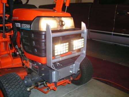

After trying three locations for lights on my BX, I finally came up with a suitable location.
First I located them on the foreword, outboard edge of the floorboard. This worked well until the FEL came along.
Secondly, I located them on brackets above the front wheels. This was OK from a lighting standpoint, but the FEL mounts would drag across them during removal.
It was when I saw the BX grill guard, that was mentioned here on TBN, that I thought there might be some possibilities for mounting the lights.
After receiving the grill guard I decided to remove the center tube and mount the lights on the lower one. (Perhaps it could be special ordered without the center tube. That would save a LOT of work considering sawing, grinding, filling and painting.)
Realizing that the grill guard must be removed in order to remove the cowling, I installed a trailer light connector to facilitate this.
Hopefully this will inspire some ideas for some of you on the net.

Really?? I don't need to remove the grill guard on my BX2200 to remove the cowling. Just Slide it forward and up out- just did it yesterday for an oil/filter change.
Unfortunately, the grill guard also comes off for installation of the front quick hitch, which means the lights would also be gone during snowblowing/plowing season or when any other front accessories were mounted- such as a sweeper.

Good points. My lights protrude slightly to the rear, making it difficult to remove the cowling.

I would say that you did a "heck of a nice job" designing and installing your grill lights. Thanks for sharing all of the details.

I agree, that is a top shelf job, they look real nice. For my application, I needed light mostly while using the snowblower, so the low mounts would not work for me. I chose to mount on the FEL.
Some here are nervous about this, but, I am willing to accept the responsibility for a functional set of lights. If I ever add a Woods Hoe, I can easily turn one or both around for rear visibility, too.

I see 2 problems with your set up.
1* the fel bucket will still block the light from the lights you installed just as it does the tractor head lights.
2*You lost the grill protection by removing the center section of the grill guard.
Those 2 lights won't stop much of anything from crashing into the grill and are just 2 more objects that could be rammed into the grill when something hits the lights.

I would have put a light on a swinging pedestal and magnetically attached the pedestal to the top of the FEL cross member.
This way the light would go past the feel bucket and I would not be reducing the protection offered by the grill guard.
