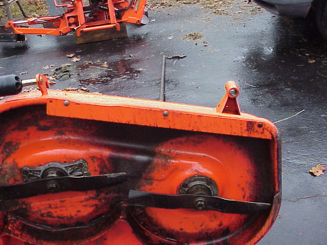

While cleaning my BX mower for the end of season storage, I started to think about the metal strap that goes across the lower edge of the right hand side of the mower deck. It is my guess that this strap is to increase lift of the grass on the right hand side of the deck to help the grass clippings move to the left side where they are discharged. If this is the case, then will it help to add an additional strap to the left side of the mower deck to increase the suction on that side as well. That combined with Gator blades might made the deck a lot more powerful for lifting and cutting. The mower deck manufacturer has already punched the holes for the plate (strap) and it would be a bolt on addition without any effort at all. What did Kubota have in mind when they punched theses holes is a mystery for us to solve. Has anyone ever done this before and if so, what are the results?

Dusty, I'd have to go dig the mulching kit of mine out of the shed, but I "think" I remember that the mulch kit has a similar plate on the opposite side, such as what you are thinking of doing. If that's the case, those holes are where the kit bolts on (along with about 6-8 other small bolts).

When I added the grass catcher to the BX-2230 with a 60 inch deck the added plate was in the kit to help with the lift. The plate does change the fact that when you mow taller grass it does not always get all cut on the first pass.

Dave.... are you referring to the plate that goes near the outlet for the grass catcher, or along the leading edge of the deck. I have the "diverter" plate that is supposed to help the vacuum work better, but I am wondering about the plate for the leading edge on the right hand side.

Got a updated discharge adapter for the 60 inch deck, plate was included that went along the leading edge of deck to match other side, the deflector that went at opening of the chute was not there nor the short bungee cord and the install instructions were not updated for the changes made , the boot kit is also used on a 60" ZD mower deck now.

It is for deck reinforcement, as this side will be bumping off trees/house/fence/poles/mail box/etc. After 20+ years mowing with the old Cub Cadet, that side was the most damaged part of the deck.

Those sort of plates are usally to stop grass blowing out the front of the deck.
