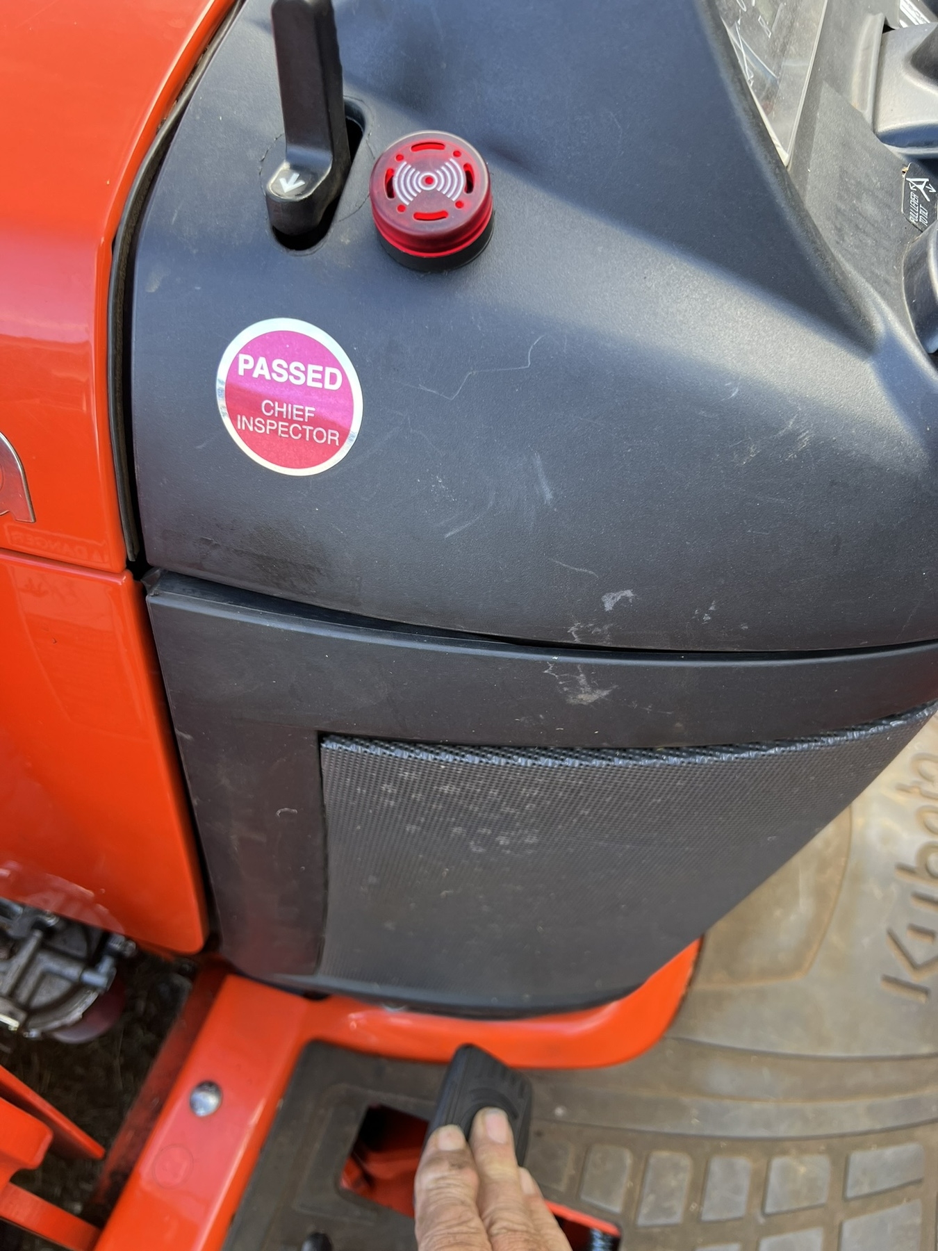

Installed parking break light on Sophie’s BX
Light with alarm. Not constant, blinks on and off.
Magnetic switch on pedal. Not happy with wiring as it is connected to battery for now. Would prefer to find a keyed circuit. Pulled cover on fuse block, but no obvious way for a new connection. Is there a terminal block on the BX

When I had a BX2350 I never could figure out how to tie into the fuse block. Someone smarter than me maybe can help you. When I added lights I just stuck a wire in the positive side of the battery and put in a fuse right after that.

I have a BX24. I had the same issue of being able to drive it in low range with the parking brake on and not realize it. I felt like the parking brake wasn't holding well enough when I needed it to, so I adjusted the brake shoes. It make all the difference in the world. I can still move it low gear with the parking brake on, but I notice the difference immediately. In high gear you cannot move.

Great idea. I forget about mine being set even with it having a light on the dash. Mines an l4060. What switch did you use for it?
