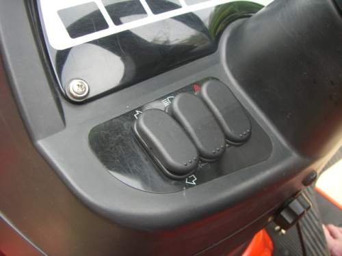

I finally got fed up with having to clean out my inferior "waterproof" BX light switches and found proper replacements. They're true "marine-grade" (IP66) and fit perfectly. The only concession was having to make short jumper wires to bridge from the turn signal connector to the new switch (or you could just cut off the connector and put disconnects on the wires).
They're Ancor Surf 'N turfs. You'll need 2 SPST and 1 SPDT. Best price I found was at wiringproducts.com, total cost with shipping about $21.

Looks good, nice fix. These OEM switches should have ever made their way to the dash of a tractor......
