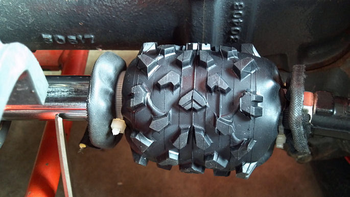

Cheap soft rubber, poor design! It should have a hard (metal) shield with the joints in such an exposed spot. ATV`s do for CV joints. I think maybe a 1/2 piece
of 1" conduit clamped over boot would shield it.
   / BX Tie-Rod boot ripped
#36
This is caused by driving thru sticks and bushes.
**Any shield** could pretty much eliminate the problem, even a bicycle inner tube over it. From the "HOW-TO" below you can see how easy it is to add a bicycle innertube over the existing boot. Electrical conduit would work too, but design that if it gets bent (jammed into the boot) that it doesn't rip the boot itself.
Here is a link to a HOW-TO for replacing torn tie-rod boots. It's a fairly easy job, the most difficult part is putting on the spring clamps without ripping the boot. Might be prudent to use zip-ties, and not pulled so tight, to allow the boot to slide off, (instead of rip) if it is being hassled by a stick. I think the spring clamps (if you don't rip the boot during installation) are detrimental to these boots. I sold my BX (with new boots) but if I was keeping it, i think I'd remove the spring clamps and replace with zipties, and not real tight.
   / BX Tie-Rod boot ripped #37
My Redneck Boot Cover
