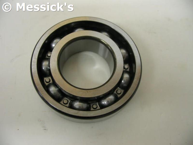

When I bought my ZD21 in '09, it had the blade bolts stripped in both outside spindles. I ordered replacements along with new bearings, the bearings are not sealed. I would think that the deck on the bx2200 has the same spindle bearings. I don't remember, but I presume that there is a seal in the bottom of the spindle, might blow that out with too much grease.
