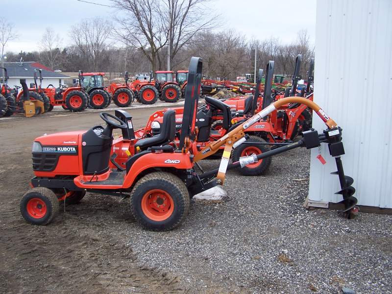

I noticed on a few boards that a post hole digger is not recommended on a BX15, I knew the backhoe was not an option, but I was sure I could use a post hole digger. I dont want to jump to a BX23 just to use the post hole digger.
Recommendations or suggestions?
I have a few acres I need to fence I REALLY wanted to justify the BX15 so I could use the PTO post hole digger.

I was at a dealer last week that had a BX1500 sitting on the lot with a Woods PHD on it. Looked like a good fit.

The BX1500 is not "more limited" than the BX1830/2230 when it comes to the 3ph from my comparisons...............Actually the 1500 and others are close to the same except the 1500 is slightly shorter in the engine bay front end area and can turn shorter.
If the 1830/2230 handles the PHD the 1500 should be able to also. The one thing the 1500 does have though is slightly smaller rear tires which might cause the PHD to sit 1 or 2 inches lower while on the 3 pt hitch.

I think you ended up getting the 2230. But for any BX1500 owners interested in a PHD, I snapped the attached photo at a Kubota dealer near Lansing, MI yesterday while in the area. They had a Woods PHD25 on theirs.
KB

Yes you can, I have a gearmore phd with 8 and 12" augers. I have not run this into rocky soil yet so I have no way of giving you an idea of how it will work in those conditions and its stll wet here so the 60 holes I dug were cake. Remind me to try it in august when everything is baked back over. /forums/images/graemlins/grin.gif
   / BX15 and a post hole digger? #10
</font><font color="blue" class="small">( could you dig post holes with the BX23 BH.?)</font>
I have a full sized PHD made by Greene, purchased at Northern Tool for about $360 and 42" augers, 14" dia. @ $120 & 6" dia @ $80. BX2200 lift arms must be at mid-height for full spread to get the U-bar on first. There is 6" of clearance at full height with PHD on. Won't dig in hard clay and in wet clay you may as well try to drill a hole in a milkshake. Clay must be at perfect moisture content to work. Other soils should be no problem. Power is absolutely no problem on my BX2200 when soil conditions are correct. It will drill a full depth 14" dia. hole in 5 seconds. To dig in hard soil you can get a Land Pride unit with rear hydraulic downpressure and carbide fishtail auger tip. Price including modifications to BX for rear hydraulics runs a bit over $2k. TBN member Ultrarunner has one on a BX23.
