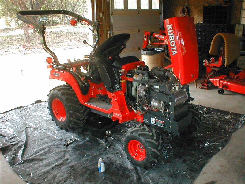

Before mine I obsessively read the threads here. I planned to spend the whole day and was done in two hours.
I agree you should remove implements and the engine cover. This is a time to really get to know your machine, clean the innards, start figuring out what that maze of links and hoses does on the bottom side.
Congrats!
