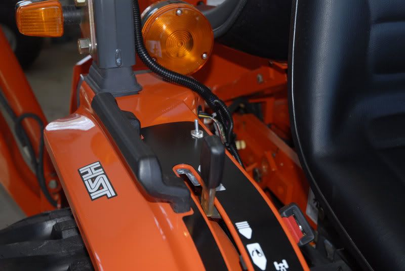

Nice job. You won't have any problems with the ROPS, the ROPS police came after me after I posted a picture of a couple of drill holes in my ROPS to PROPERLY secure my lights to it. I don't think that all the brackets people come up with are particularly efficient or nice to look at for that matter, but some have come up with good ideas.
The argument altering the ROPS is a CYA move from manufacturers because I'm sure some people with no common sense have done some retarded things to the ROPS and decided to sue when the thing failed, so you can't blame them (manufacturers) for covering their butts. Unfortunetly that gives voice to the ROPS police to start chanting when they see someone who has the gall to ignore the warnings and *GASP* put a 3/16"" hole in a steel structure.
A short weld or a few well placed holes will NOT harm the ROPS. Again common sense. Don't weld/drill in the bend areas, keep the holes small, weld in small beads or tacks, etc... What do I know though, I only use to be an aviation technologist repairing aircraft fuselages!!!!
Here's mine.
Originally I was going to run all the wire inside the ROPS but that would make it harder to wire up more lights later on. I may still do that eventually though.

Not much to tell, they are just regular driving lights for a car, flood not spots, throw a ton of light. I went for the oval lights for the headroom but I've seen some tiny round ones that are just as bright. Lights have come a long way in the last 10 years or so! I'm still running on the dynamo, so I can't add anymore for now until I upgrade to the alternator.
They are 50 watt halogens so when I'm running all the lights, I'm pretty much using all the output the dynamo can give me. Fortunately they throw an amazing amount of light so I don't have the headlights on when they are running. They are not used often, mostly only the odd time in winter for snow clearing. Rarely do I have to use them in the summer as it does not get pitch black here until 1030-1100 pm during the summer months. They are fused directly to the battery with a switch on the right side fender.
I had a fancier switch but it got whacked off by a branch when I was grubbing some pretty wild bush, so I went with the steel switch, no problems since, but I'll probably put rubber switches on the dash or put some kind of rocker switch panel where the switch is now. I will add more lights (after I upgrade to the alt!!!) :) One large light pointing backwards would be handy.
Couple of more shots....
