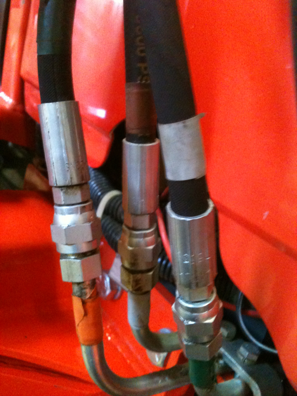

Hi........I have a buddy with a 2002 BX1800. He just self installed a Kubota LA211 loader. Loader works fine, but 3 pt. wont work unless you simulataneously curl the bucket.
He has checked all connections, nothing looks out of place.......maybe air in the system?

It sounds like he has hoses connected the wrong way around. I had an issue a few years ago when my line for the power beyond was not staying connected. Have him check his hoses and to where they are going.

Sounds like perhaps the power beyond and out lines are mixed up (coming out of the loader valve).

Thanks guys! Does anyone have a link to a schematic or something we could check it against?

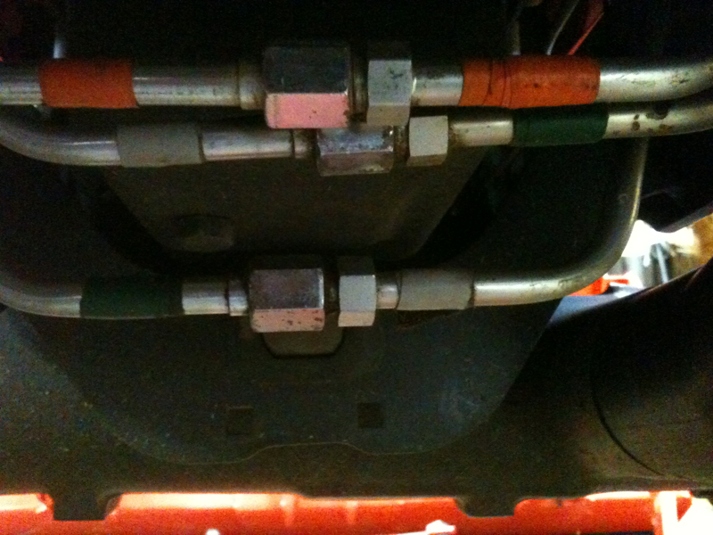

If memory serves me right, Kubota's markings on the two piece lines were not right on mine. The had the lines crossing over each other when they went under the tractor. If I get time tonight I will look again at mine, since I have it torn down for BH install.

The set up for the loader valve if you are looking at the valve is as follows:
Left Top: Blue
Right Top: White
Left Bottom: Red
Right Bottom: Yellow
The hoses on the loader side should be color coded and connected as noted above colors.

Not sure how I figured this out, but here are the photos of my connections:
