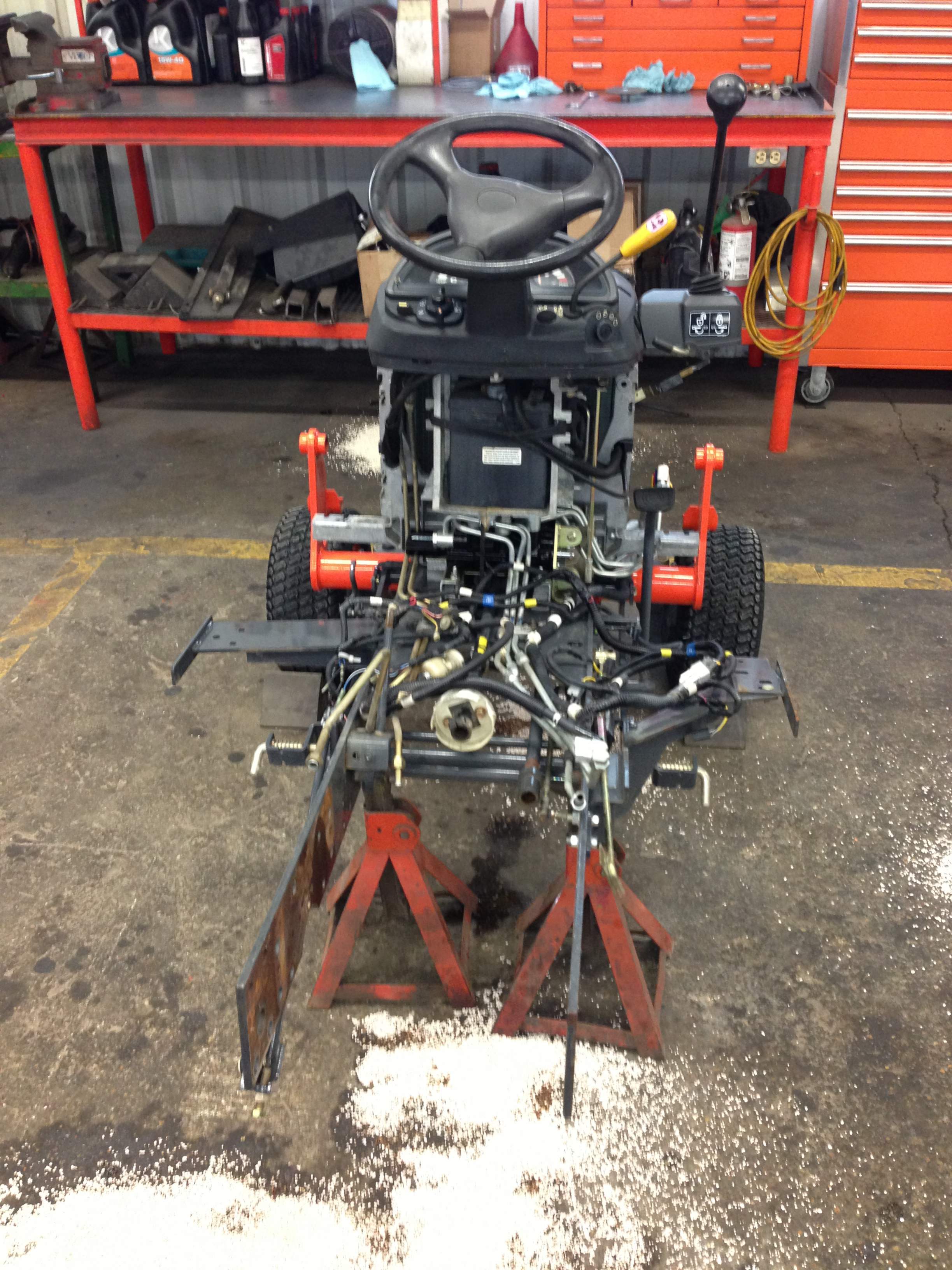

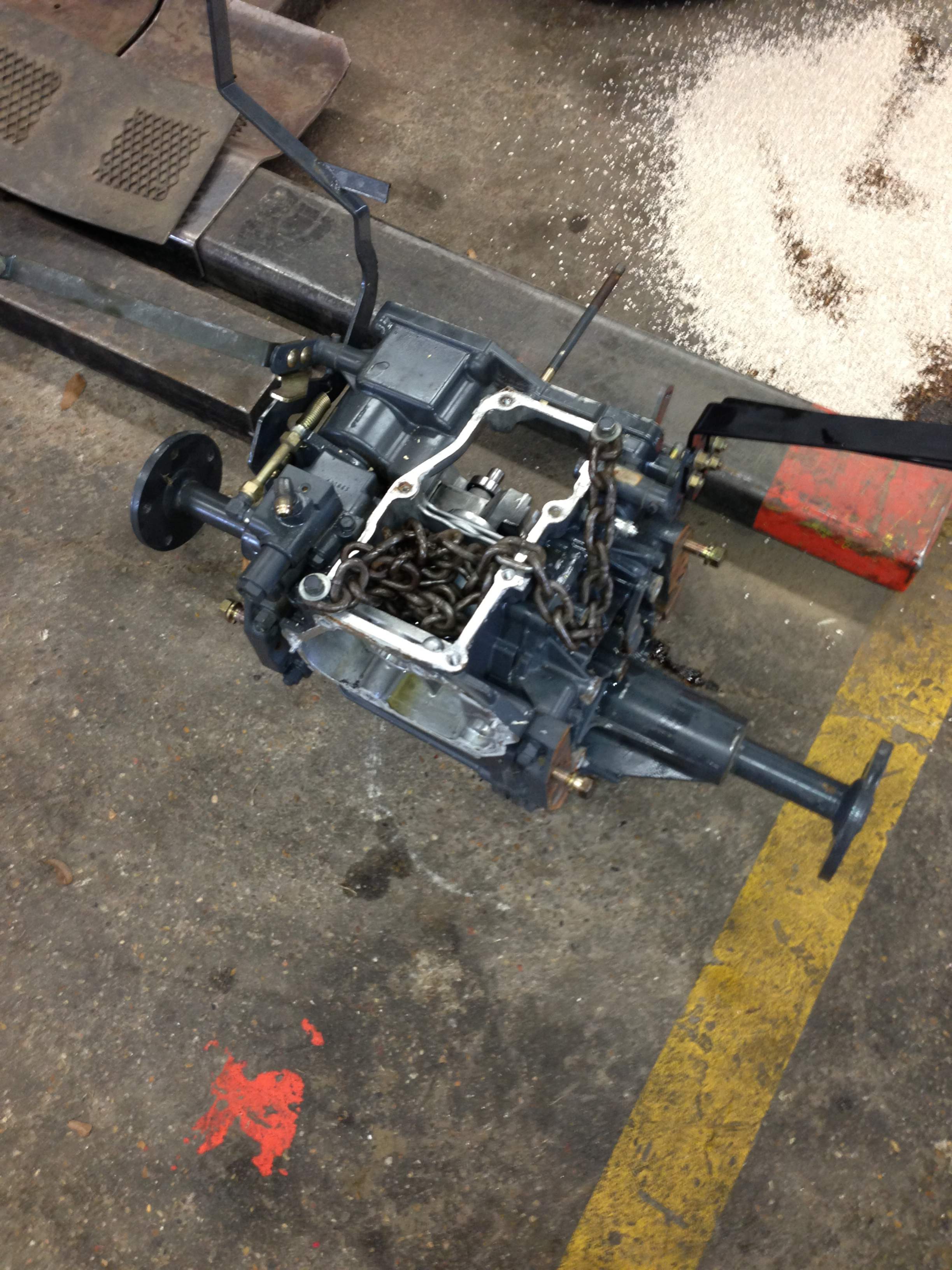

Well I dropped her off at the Dr.'s office this morning. Hopefully I won't be squealing "like a pig" next week! I'll post up the cure for future reference. Thanks for the help.
   / BX1850 pops out of 4 wheel drive
Well, I wanted to finish up this mini saga for future reference. The diagnosis was not pretty and the cure was not cheap, but$1888.00 later a couple of gears, a shift fork and a bearing inside the HST have been replaced and it now does not pop out of 4x4 any longer. After speaking with the tech at my dealer, I was told the problem was created by shifting to 4x4 while in motion. The damage to all effected parts were very evident.
