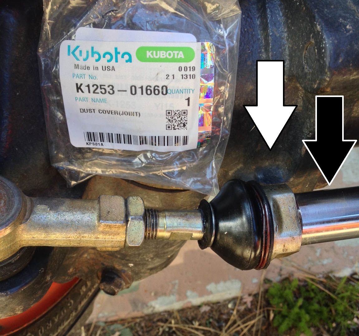

Just bought 2 new axial ball joints for my bx2200. I am having trouble unscrewing them from the hydraulic steering shaft as the shaft is rotating when I try to unscrew them. Is there a trick?
   / Bx2200 axial ball joint replacement #2
On my dad's bx1500 there are flats machined into the end of the cylinders rod so it can be held with a wrench.
If it doesn't have the flats you can try.a rubber strap wrench at the end of the rod closest to the joint.
And I know it sounds stupid but doeble check the which way it's threaded, I'm not sure if they are left hand threads.

The problem appears to be where the tie rod end threads into the rod for the hyd. steering ram, not the spindle.
Don't put heat on the rod, it can damage the chrome plating.
   / Bx2200 axial ball joint replacement #6
There are two flat spots on the end of the steering rod to hold it while you remove the joint.

I am trying to remove the inner axial balls (that have the rubber boots attached to them) and the hydraulic steering ram/shaft is spinning when I turn the axial ball.
   / Bx2200 axial ball joint replacement #9
Those are the tie-rod ends. Right behind the tie rod end, on the right side, and the exposed part of the cylinder shaft you will find two flat spots on the cylinder shaft to place a wrench to hold the shaft from spinning.
