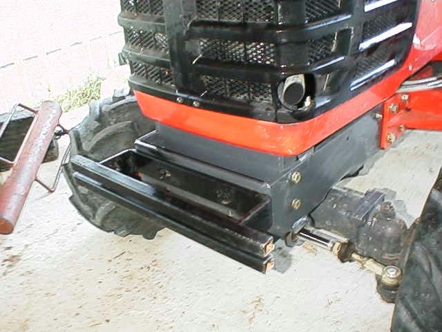

Have you ever worried about the plastic grill on your bota when you were empting the FEL into a dumpster or pickup?
I did, so I built a bumper out of 2 pieces of heavy wall 1 inch square tubing 19 inches long and mounted them on a 1/4 inch piece of flat stock (actually scrap metal from another project). Now I can ease up without worrying about messing up the front of the BX2200. (see photo)
