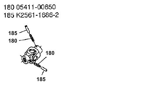

Jul 30, 2003 / BX2200 drive shaft pin #1 E eno Member Joined Oct 22, 2001 Messages 45 Location PBG, FL Tractor BX2200 I want to know how to get this pin out. It broke real close to the universal joint. Any ideas or is there a special tool for this. Attachments 298117-UJ pin.jpg 13.4 KB · Views: 480

Jul 30, 2003 / BX2200 drive shaft pin #2 J jrlichina Platinum Member Joined Feb 9, 2002 Messages 538 Location Mukwonago, WI Tractor BX2200, '52 8N That's just a roll pin, use a long round punch to drive it out. The new one with just tap in nicely with a hammer.

Jul 30, 2003 / BX2200 drive shaft pin #3 R ragman Bronze Member Joined Apr 19, 2002 Messages 51 Location Green Garden,Illinois Tractor BX22 TLB mine broke 2 times in the last 2 years. I just keep a couple extras in the garage just in case. Now I'll propably never break another one cause I've got spares now. Just pop it out with a long punch and tap another in.
