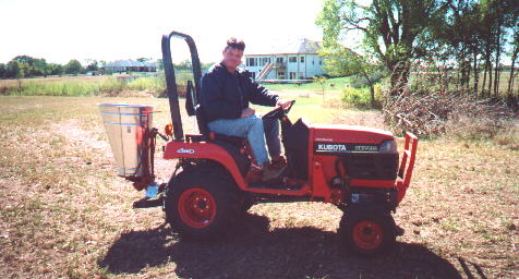

I think you are worrying about nothing. The BX engine is nothing new for Kubota. It turns a little faster than some Kubota engines to get the 22 horses but just marginally so. Kubota has been building little 3 cyl diesels for a long time and most of them are still running and the BX engine will be no different in that regard. It will likely out live you given proper care. It has the same rapid torque rise and flat power curve Kubota diesels all have. For loader work and Box blade I run it per manual at about 1700 to 2200 RPM occasionally a bit more with the Box blade, for mowing I run it at about 2600 to 2800 RPM and max goverend RPM is 3200. The BX2200 is a 55 cu inch engine and the 7400 is 44 cubes and the 7500 is 61 cubes. The BX1800 is 43.9 cubes and the B2410 is 68.5 cubes. The BX engine never seems strained, it just loafs along, typical small tractor engine. Good luck, I think you would like the BX and I think engine life is not a concern. By the way, mine uses no oil--none--NADA-zip and the oil stays fairly clean looking for the 50 hour change interval. Now that the rings are seated in I think I will switch to Mobil 1. J
