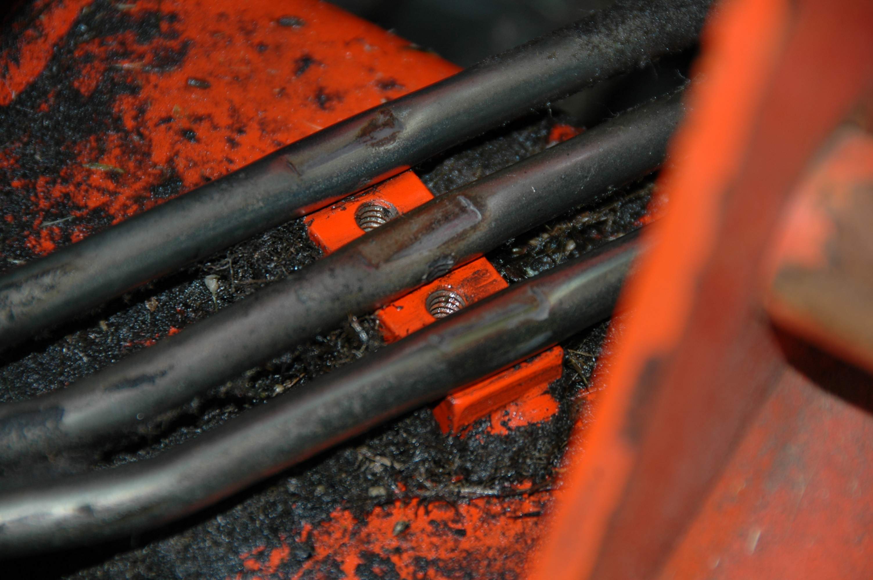

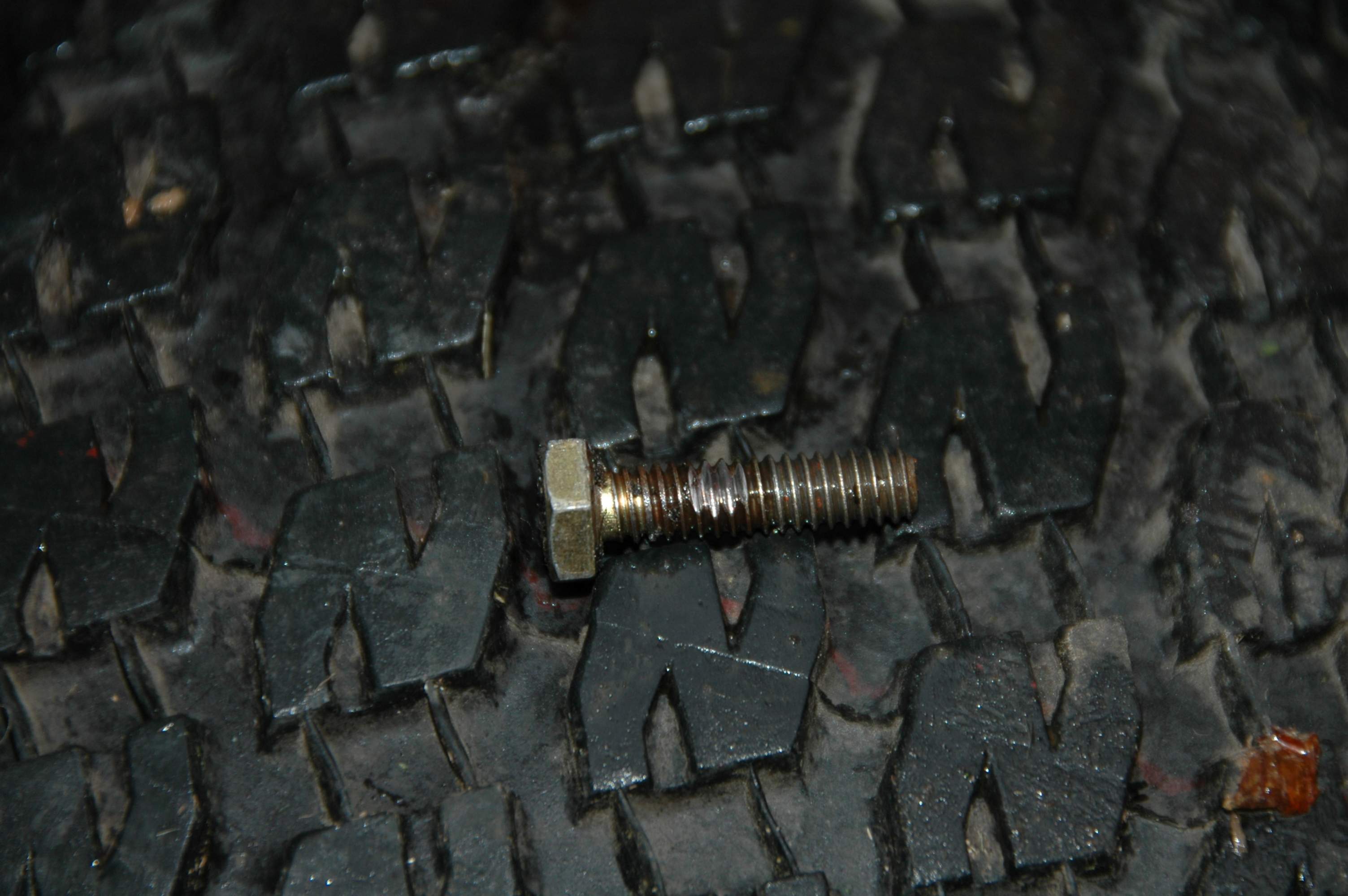

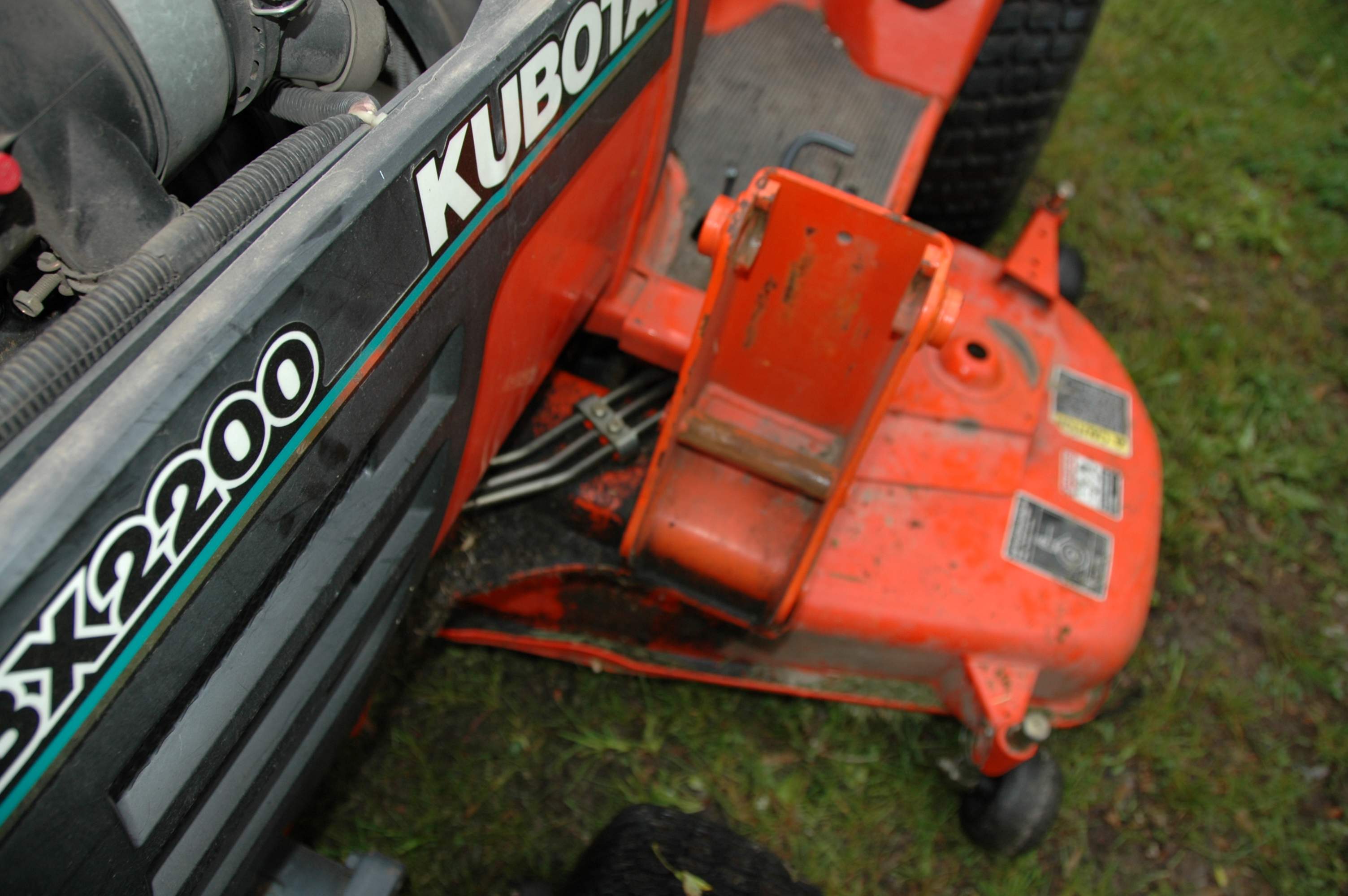

I've had my BX2200 for a week (600Hrs)and and used it once. Just my luck, a hydro leak. Easy fix, but have to wait for the line to come in. Just thought I'd post a few pics so you know the area I was talking about. Don't forget to check the steel line clamps turned out the bolts were lose, vibration wore a hole in the line.
Thanks for the heads up..I will definitely give that area a look.
   / BX2200 FEL steel line hole. #3
Appreciate the notice. I completed my hydraulic fluid, oil and filter maintenance yesterday and did a quick check for fluid drips but will take another look at those lines.
