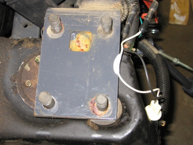

I have a short in the headlight circuit and was wondering if anyone else with a BX2200 has had this problem. There is a brown wire coming from the hl switch and brown wires going to the headlights but the wires going to the taillights are white. The schematic I have shows brown wires going to all. Is there a connector somewhere in the harness I can disconnect to separate the taillights from the circuit so as to narrow down my search for the short?

I have found the problem to be with the wiring to the left (sitting on tractor) taillight. I found by tugging on the socket I could get the resistance to ground to change. When I tilted the seat forward I noticed the top of the fuel tank showed some fuel on it. I also have the problem of blowing the same fuse when I fill the tank so I guess I have one of the infamous bad tanks and sender units I see posted around this forum. I might as well fix everything at once since I have to take the fender off to get at the wiring. Are there any tricks to removing fenders and tank? How do the handle covers on the PTO levers come off? I tried pulling on one but it wouldn't budge. Is there someplace besides the Stealer that I can buy a factory shop manual? Thanks for the past replies-any and all help is appreciated.

Thanks for the service bulletin, Tom. I took the fender off and you can see in the attachment how the taillight wire was jammed between the fender and the ROPS frame. You can also see the fuel around the sending unit. I received the repair kit for the sending unit and will have everything back together tomorrow. It took me a while to get the unit out of the tank because I was afraid of breaking the PTO safety switch when pushing down on the tank.
