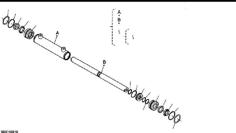

Here yuh go just in case you need some help figuring out where things go when you start to put it back together.
Don't know what your seal kit cost but mine was $76.00 so you don't want to mess this up.

Thanks David. I do have the WSM for my BX2200. I bought the kit last year and am just getting around to using it. I don't remember what I paid but I don't think it was that much. I bought it from Messick's.
