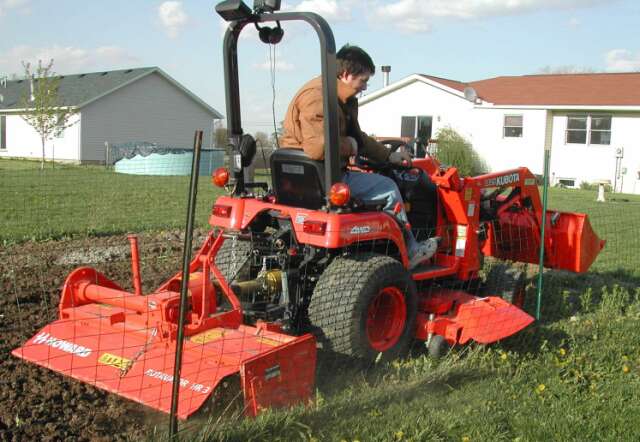

Here is a pic of the Howard HR-3 50" on the back of my BX. Here I am tilling our small garden up close to the house. the back garden/field still to wet to till....
I do store it on a dolly in the shed, which does make it much easier to store in the shed.
