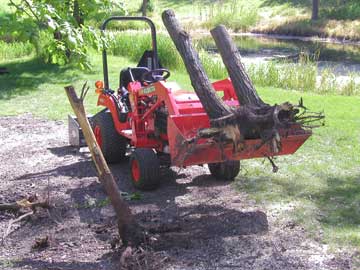

I've been clearing some woods to expand my backyard (will post other photos in "projects" soon) and have been amazed at what this BX can do.
First I clear away all the brush, then fall the tree. If the stump is 3" or smaller I just hook up a chain and yank it. For the larger ones like the attached, I push/pull with the loader. The first time I shoved on the one pictured it didn't even shake. Had to dig around it a little then was able to push it over, get under it and push some more tell all the roots snapped or came out.

My 2200 has pulled some large stumps as well and hardly strained. The hst in concert with the 22hp plus 4wd and a low range really get the job done
