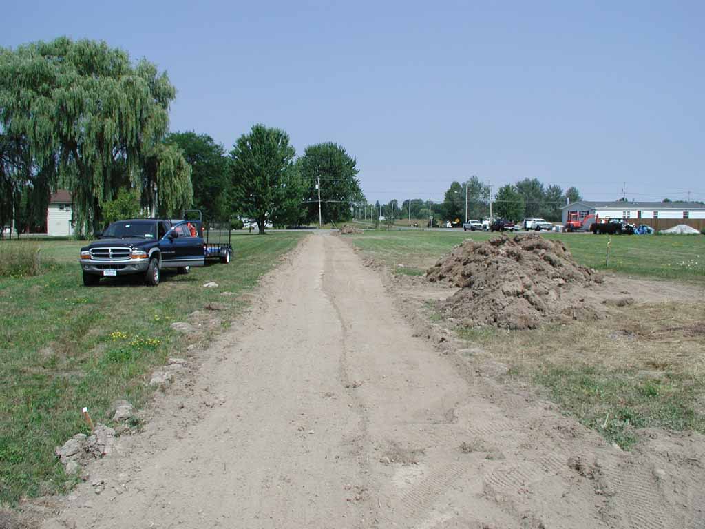

Congrats on your BX2200. I have a BX2200 with turfs on it and I just finished putting in a 400+ foot driveway and did not have much problem with traction. My problem was the tractor could only dig a little at a time because it lacked the power to dig up the ground. I attached a picture of my driveway I cut out with the tractor.
I do not have a MMM so I can not answer your other question. Good luck with your tractor.
