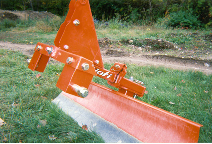

I have a BX23 and so far I have 3 different implements for it - a Woods GBC48 Box Blade - which is their "Estate Series" made for the SubCUT tractors, a Kioti RB22-60 rear blade (made by Midwest) - which is a full Cat1 compliant blade, and a Speeco Cat1 quick hitch. Both the Speeco and the Kioti rear blade fit right on the 3pt on the BX with no problems. The problem I did find with the rear blade is that I did not have the lift height to get the thing off the ground. The Woods box blade also fits right on the 3pt with no problems and has good lift height with no modifications - as it should. I believe the difference between "limited" Cat1 3pt's and full versions are simply lift height and lift capacity. The Woods box blade I believe is made to be slightly lower to the ground than a regular Cat1 box blade would be. If you think about it this makes sense - the ground clearance on a SubCUT tractor is probably about 6 inches lower than a typical CUT size tractor - which means the whole 3pt mechanism on the SubCUT is that much lower to the ground also. This limits your lift height quite a bit. I fixed the lift height problem on my rear blade by extending the lower mounting points down about 6 inches and now the blade has more than adequate lift height. ( see attached picture).
