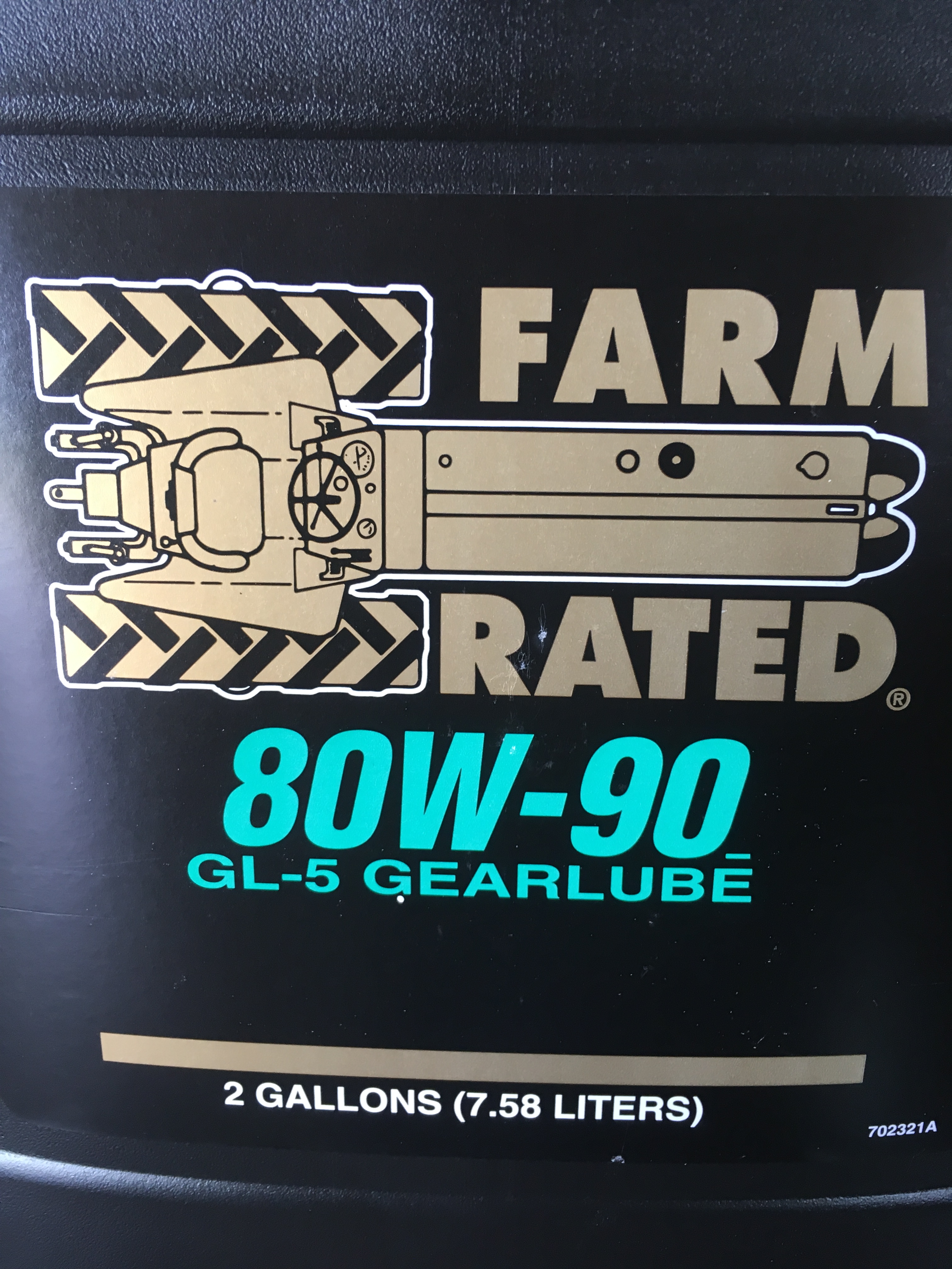

Will this oil work for both front axle as well as mower deck gear box? Gear box calls for .38 quarts SAE90 API GL5 gear oil. Front axle 5 quarts SAE80 or 90 gear oil. Thanks for helping!

   / BX2230 front axle oil change #9
Probably same stuff I got at the farm store but in a 5 gallon bucket with a different name on the it. Been having slight leakage at the bevel gear seals so put a little Lucas in it and cuts down on the seepage.
