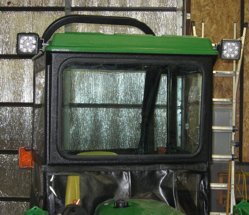

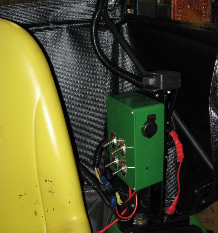

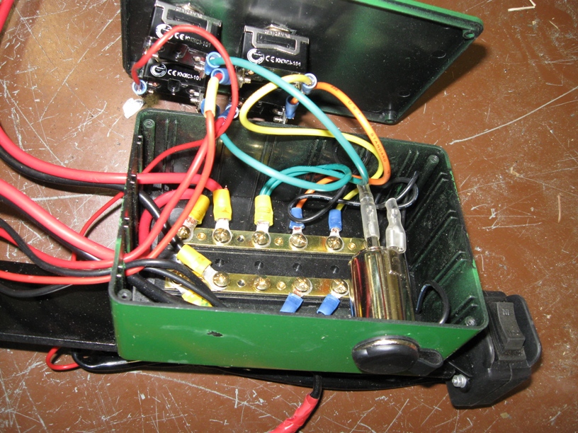

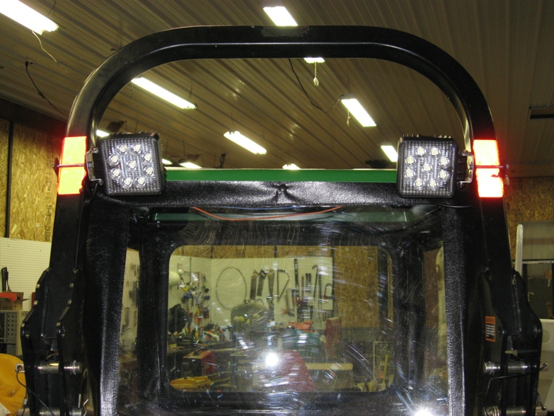

Here is what I did. I ran a new set of wires from the battery to under the seat with a circuit breaker on the hot side of the battery. I built a switch box from a plastic project box and a mounting bracket so it would attach to the base of the ROPS. I only install my lights and and the box in the winter when I have my soft cab installed. The box has four switches. The top switches independently control the front lights and rear lights. One lower switch turns my rear view camera on the the other one puts power to the winch that rotates my snowblower chute.

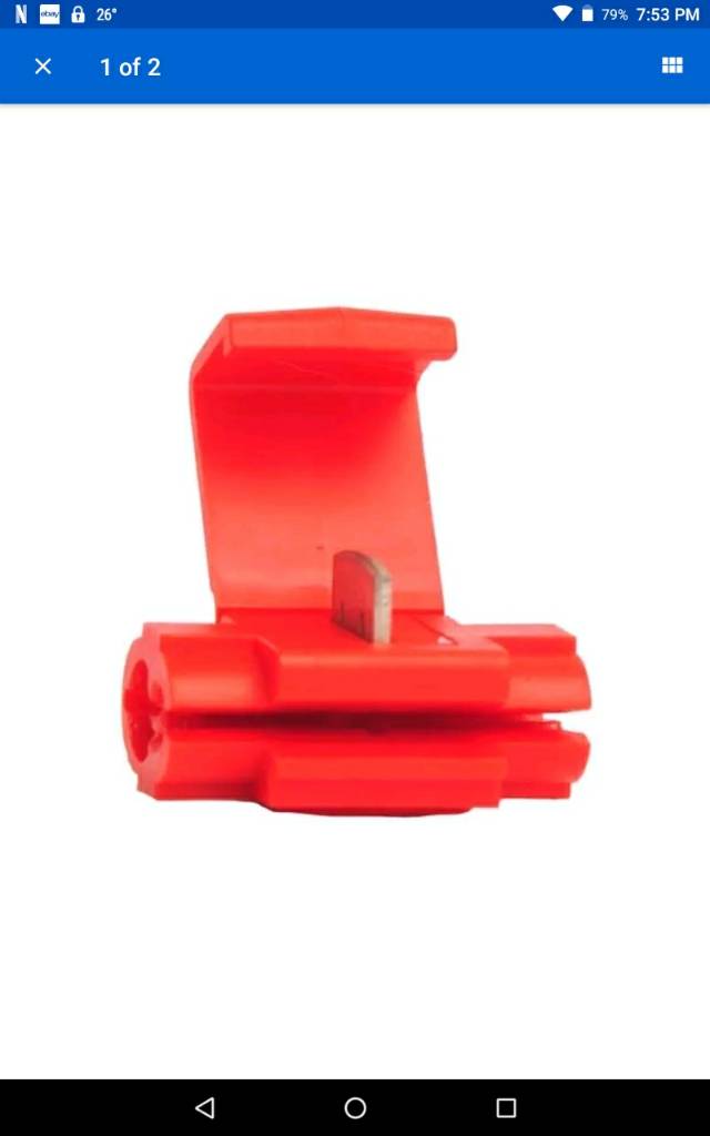

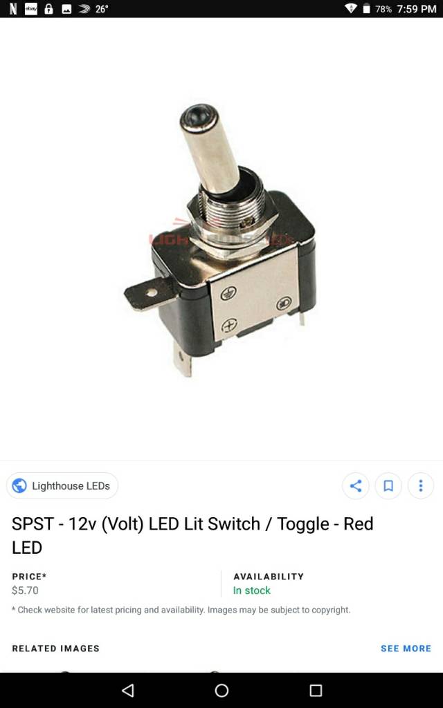

Thanks Radioman, I do have a simple led toggle switch. So do I just use this connector and cut into the power (red) wire and connect the other lead to ground? Screenshot_2017-12-15-19-53-39-405.jpegScreenshot_2017-12-15-19-59-26-580.jpeg

Looking at yout switch... You have 3 terminals. I suspect that the bottom two is for the red side of your wire. You need to physically cut wire and crimp on a push on blade type connector on both sides of wire. The third terminal that is for allowing the led to lighy up i suspect and you need a wire from that terminal and use the plastic connector you have shown to the ground wire that goes back to black side of wire . if i remember correctly the wire bullet connectors on tractor wasnt color coded i think... You need to use the meter to confirm the positive. And negative side. Just be sure positive goes to switch on bottom terminals ans side terminals uses the pish connect on wire going back to negative side. Mind you.. Do all the cutting and splicing on the wire you ran side only. Never on tractor original wiring
