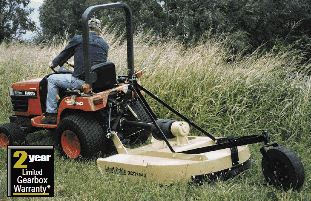

   / BX2230 max weight for rear PTO/3 pt hitch
The picture of the mower on the Land Pride site shows it being hauled by a Kubota tractor that looks a lot like mine, but it it's red and small I think it looks a lot like mine. If I could figure out how to attach a picture to a post, I would.
   / BX2230 max weight for rear PTO/3 pt hitch #5
Looks <font color="orange"> Orange </font> to me. May be a BX1800. I do not think you have a problem.
<font color="orange"> Kubota </font> shows a RFM48 that weighs 450 lbs as a available attachment for your tractor.
