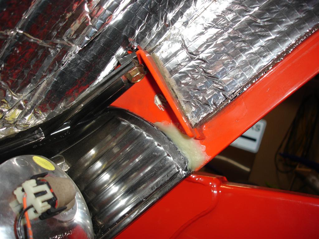

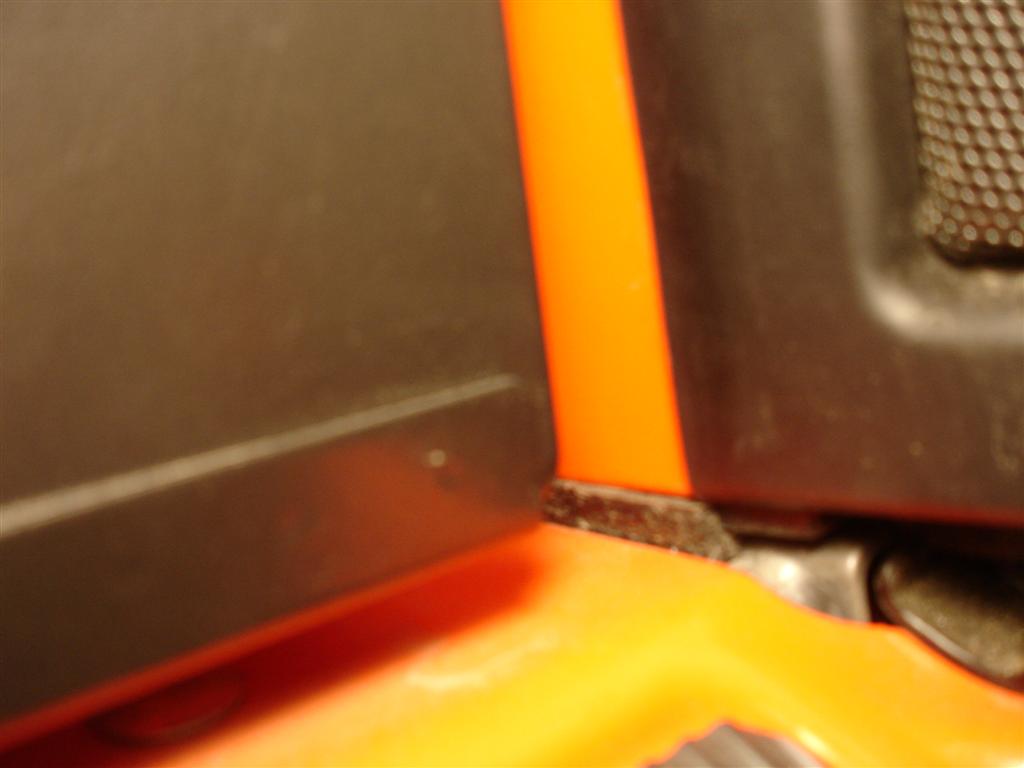

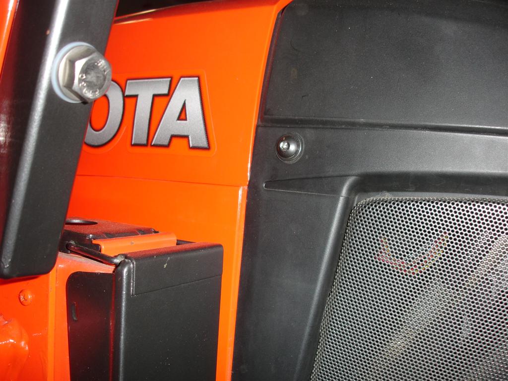

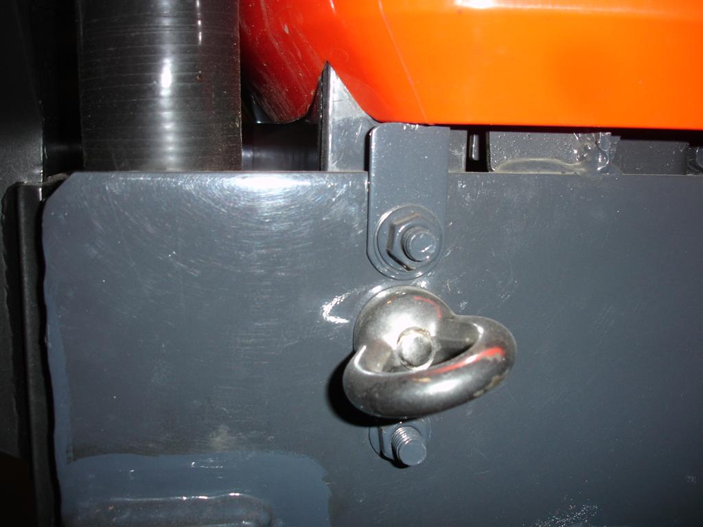

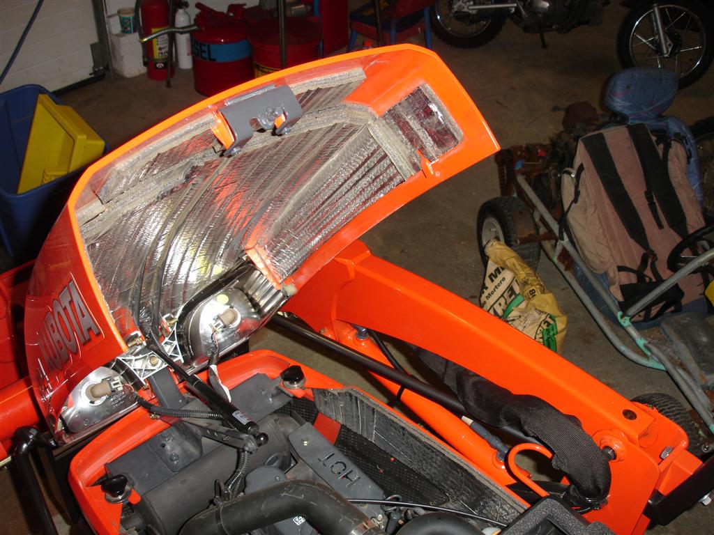

Creex,
Had similar issues regarding #2 when I got my bx24 - cowling vibrated & fit wasn't great. In pic #1, I put a support under the lower front corners of the cowling (it's above the stainless eye), in pic #2 I put a rubber bumper under the rear edges, in pic #3 I installed a hex head cap screw in the battery cover which pulls it in against the cowling (you might be able to do something similar to the area where your tab is missing) pic#4 I epoxied the joint between the headlight assembly and the hood on both sides, #5 I installed sound deadening foam to the hood and cowling (the stuff is lead cored and very heavy) which dampened the vibration - quieted the motor too. Also in the last picture I substituted the stock washers under the black knobs that clamp the cowl with the bigest washers I had on hand - also put a rubber washer under them.
Can't speak to the backhoe as the mount may be different than mine.
Dave

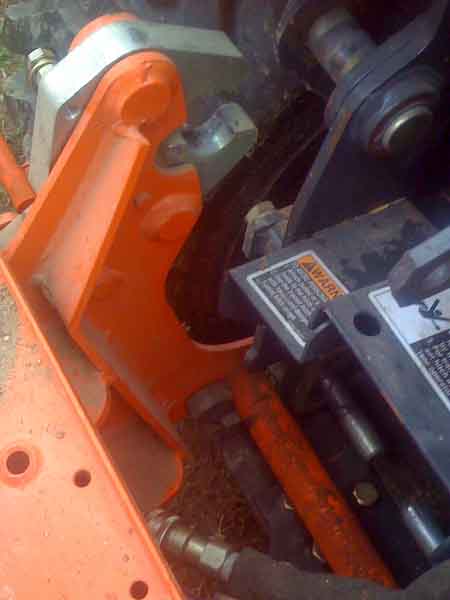

Ok it was drizzling a little bit but I got it out at shot a couple pics with my cell phone.
This is how I start, level ground and nothing under the backhoe.
A little up pressure to get the tension off the latches.
In this picture the lathces are as close as they ever get to the sheetmetal.
There is about an inch and a half clearance
You can see where I bent the sheetmetal the first time I did it with the outriggers down.
Here you can see the bottom hook. You need to make sure that the cross bar is completely seated in these hooks. If not that could cause the backhoe to ride higher and hit the sheetmetal but I think it would come loose as soon as you started digging.
Here it is rolled all the way back from the tractor. You can see how it rolls down and back. At this point I would pick it up off the bottom hooks with the outriggers and drive forward a few inches then set it on the ground.
So there really shouldn't be any need to trim the gussets. But if you still want to I don't see reason not to.
Hope this helps.
