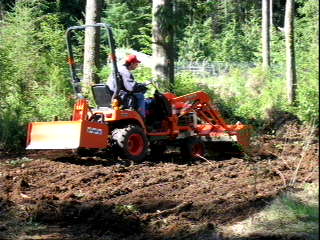

Here is a pic of a 48 inch box scraper on my bx. It is my most used implement. You can see that with the toothbar on the fel and the box on the back, you can clear and level pretty easily.

How in the HXXX did you get that big stump out..I have a stump that's 1/10 the size, completely dug around..and I gave up on it.
Did you use the pickup?

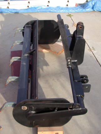

I use a Gannon rollover scraper on my 22. Gives you a push, pull, and tooth option. Very versatile, but very expensive. I use it primarily to maintain my horse arena.

I had to break it into peices. I had a winch on one leg, tractor on another, and a truck on the third. I would put tension on all three and let it sit overnight. You could hear it creak. Next day I would put on more tension and so on. It took 3 days and it finally split into three and then the tractor could handle(barely) pulling it out of the hole . I had cut a ramp down into it to help in pulling the peices out. It was one that the trackhoe couldn't get becouse of logistics other wise I wouldn't have done it. the trackhoe I used took about 30 seconds to remove a few that size that I had. let's see... 30 seconds on the trackhoe versus 10 days on my BX hmmm...
I did get alot of seat time on the backhoe though /forums/images/graemlins/grin.gif

Thats a nice setup. Looks like it would be alot quicked than a boxblade.

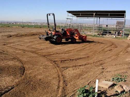

Steve, actually it was originally designed for my JD332 cat0 tractor. I liked it so much that I kept it when I sold the JD and added some outboard eyelets to fit the BX cat1 lift arms - you can see them in the earlier pic. It fits perfect. I'm using it presently to excavate for a 25'x36' barn foundation/slab. Attached another pic of the rollover mounted on the BX early in the excavation. I cut the area with the teeth, then use the "in" blade to move the dirt.
