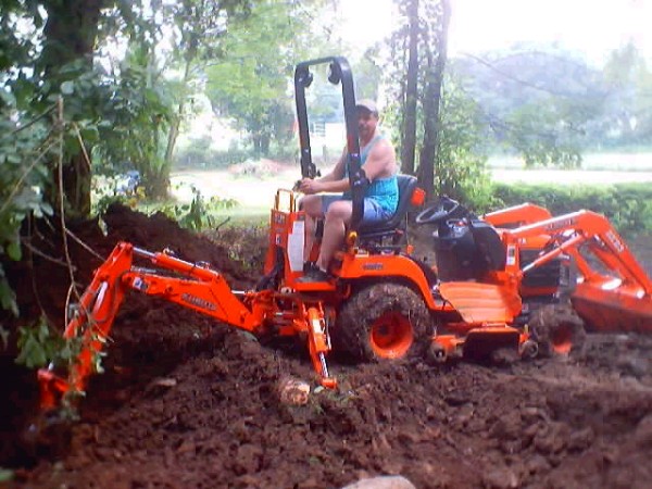

As for getting hungup. The BX23 has traction lock as well as 4WD and I have yet to get it hungup or stuck but then again I operate it within it's abilities. I used it this past summer to dig out my pond that had filled in over time. To keep from getting stuck I 1st built up a ramp down into it in the middle then worked each end towards the middle. Then I dug the ramp out as I was working back to the top and out. The ramps angle was such that I left the MMM on for protection. I would have taken it off if I had to tho, but it wasn't an issue.
The BX23 will dig all day long for you but don't be mislead into thinking it's a commercial quality TLB. It takes small bites which corelates to alot of seat time. To me thats not a negative /forums/images/graemlins/grin.gif but some others would consider it one.

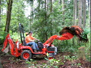

I cleared my property with my bx. There has been alot of talk about the clearance on the bx. I think it has to do with how well you plan your attack. If you watch where you are going and dont high center yourself on a log or stump, the bx does a great job. I have many pictures in the links next to my signiature that may shed some light for you. here is one of me clearing. Good luck in your quest to find the best tractor for your needs.

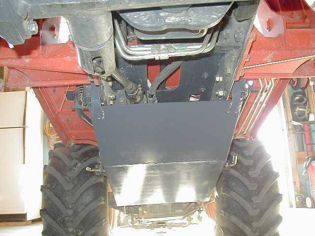

I've had my BX 2200 in the woods quite a bit and the hydro filter and the fan is vulnerable so I and some others have added a skidplate to keep the sticks from getting at the delicate parts, and it has worked for me. Anytime that I take off the MMM, I clip on the plate, it is held on with the pins that hold the mower on and it is on and off in seconds. Attached a pic, if you need more, I can provide. I have not found ground clerance to be a problem, if I can't go over, I can just go around, that's the nice part of getting around in the woods with a smaller machine.

Milkman: I really think if I take your approach and be careful, then all should go well. I definitely would go for some type of bash plate underneath just for added peace of mind if nothing else. I'm going to have to deal with some wet areas where I need to be working so that should be a challenge for a newbie like me. I'm up to taking a different approach if it prevents me from getting stuck or hung up.
Thanks for the photo of the skid plate too. Looks like I might be doing something similar very soon.
