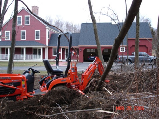

Just thought I would post a few shots of my barn preparation. I am pulling stumps and moving rocks getting to level a pad and begin foundations.

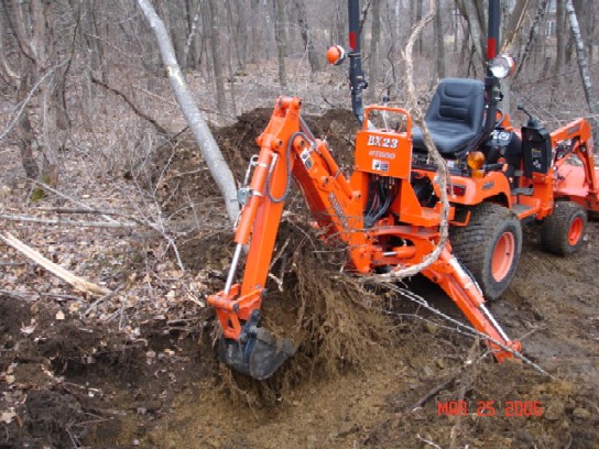

This is a shot showing the location. I removed this tree without cutting it becuase my wife thinks the saw wakes up the baby while he is sleeping? The only time I get to work on this is his morning nap on the weekends, sometimes 20 minutes and sometimes 2 hours. Oh well, as long as I get to play, work I mean, with my tractor I have fun.
For the foundation I am thinking about digging a 10" wide strip 48" deep and then using a 2x12 just to form the foot above the ground, I will use a little more concrete but save excavation, forming, backfill etc. Soil here is silty sand, a little wet, no huge boulders (that I know about). Thoughts?

Looks like the BX23 is in it's element and doing a good job.
I like those ROPS mounted spots, what brand are they?
Nice looking estate.

Thanks for the compliment, the lights are Kubota, they work great I have used them extensively for plowing and mowing.
You probably need to check with your local building code folks. I believe that in most areas foundations for buildings need to have at least a 12” high ‘footing’ that is twice as wide as your wall with the wall centered on it, that is; if your wall is 8” thick you need a footing that is at least 12” high and 16” wide. The idea is to help keep the wall from tipping and settling. 48” deep sounds good to me; here the code requires 43”.

Beautiful house you have! Really like the way the garage/barn integrates with the main house and porch. Nice NE design. Massive chimney...but there's a nice fireplace in there.

Regarding the foundation, I agree, generally you have a stem wall on a footing, but I did check with the code official in town and he is happy with a 48" deep 10" wide wall for an outbuilding. My other thought, if he had a problem, was a full 12" wall which would be $700 more in concrete but still cheaper than forming the entire thing. Dimensions are 18x20.

I was gonna mention the footing but if the inspector says OK, well then it's OK.
However, if I were you I'd pour the foundation maybe two feet above the ground. Avoids a lot of probs. Namely rot and bugs (termites). I have the rot prob w my house and garage, but not the bugs.
