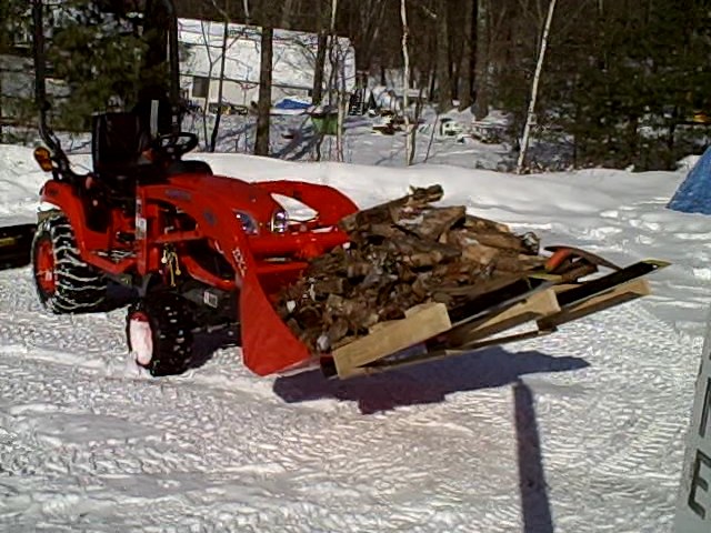

The above poster is correct. Two inches is about the required space you will need for chains. I put chains on BX-25's with both turfs and R4's without spacers. It was a tight fit, but they worked. In this shot, the tires were R4's.
