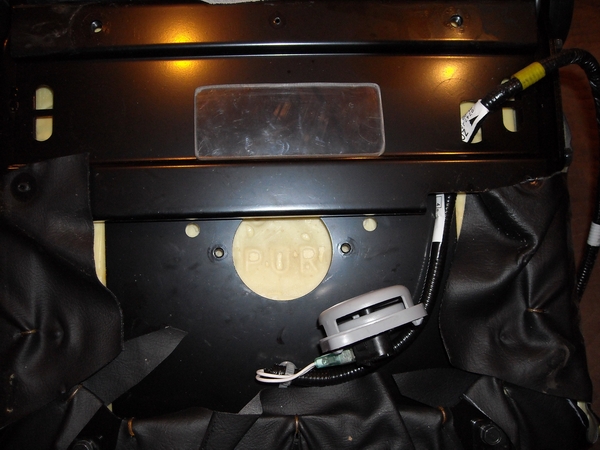

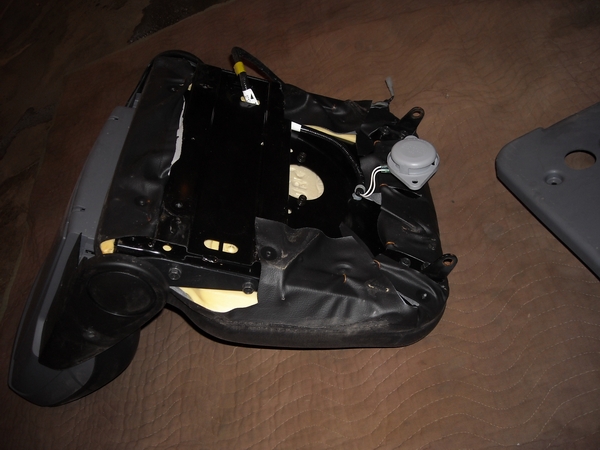

BX2660 Deluxe Reclining Seat Kill Switch Adjustment Project.

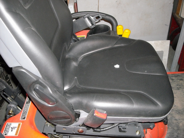

Well, I pulled the seat apart and was surprised at where the switch was located. Basicly the switch is located beneath the cushion and is located right between my legs where there is the least downward pressure. (manly equipment related comments not required.)
For the photo, I placed a white dot directly where the switch is. If they had put the switch 2-3 inches further back, there would not be a problem.
As you can see in the photo, it is a small push button switch with a 2" diameter cover. What I did was place a 2"x5"x1/4" piece of plexiglass against the bottom of the cushion where the switch goes. I placed a dot of silicon on the cushion to keep the plexiglass in place. This gives wider and more uniform downward pressure on the switch.
End result is Problem Solved. Switch works great with much less pressure.
