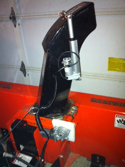

I'd also take the cover off & check the set screws on the sprocket. Mine were completely loose as were some others that reported on here.
There was a recent thread where a sprocket walked out enough to break the chain.
Welcome BTW, I'm in your area anxiously awaiting a storm to try my chute rotator & deflector actuator I installed since the last storm
   / BX2750 snowblower driveline questions: #5
like2wheel, did you make your own chute rotator or buy one already made?

Thanks for the welcome, neighbor. So far I am good with the manual rotator, but debating deflector options either electric actuator or trying a JD cable operated kit. Also planning to get an UHMWPE edge.
I used a power window motor that I had collecting dust from a previous collision repair. Despite what my wife says, It's always good to squirrel away any extra parts :).
