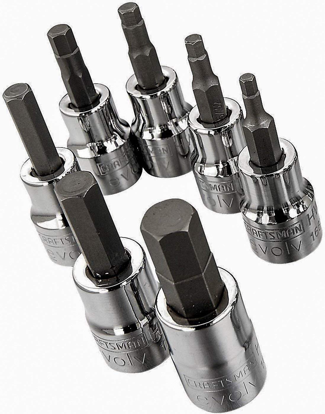

If you are using a simple "L" shaped allen wrench, you may not be able to tighten the setscrew to the proper torque. A set of allen head sockets is better for the job:
https://www.amazon.com/Craftsman-Ev...t=&hvlocphy=9007140&hvtargid=pla-569926731581
If possible, determine the factory spec and use caution to avoid over torquing.
