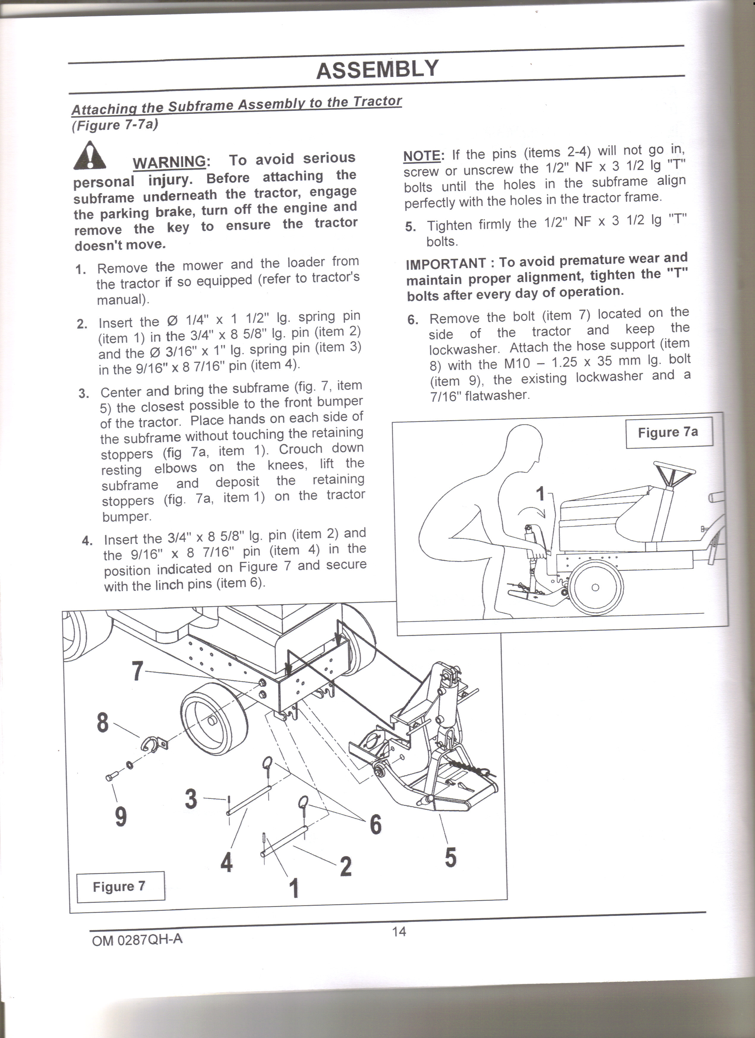

I just picked up a BX2750D blower that came with a quick hitch. I got the operators manuel for the blower but nothing for the hitch. Anyone have a set of installations instructions for the hitch. I would like to make sure its right before I break something?? I did a search but turned up nothing but a couple of dead links. Thanks everyone.

There are two ways to put those wedges. I do NOT have mine properly kosher, according to the manual. Just so you know.
They show them in the manual with the incline catching the top of your front steel bumper by wedging friction. I just did not like that method at all.
You see how I have mine. It works very well for me and I am very careful when installing them. If you have any issues, revert to the way you are "supposed" to install them.
There are a couple of other possibilities in installing those wedges and they would be just wrong, wrong. Your hitch would slop and not be tight. Your hitch plate should smack on to the steel of the front bumper. Square. If you don't have that square face to face feeling, then start over.
This is the page from the manual,hope it helps.
