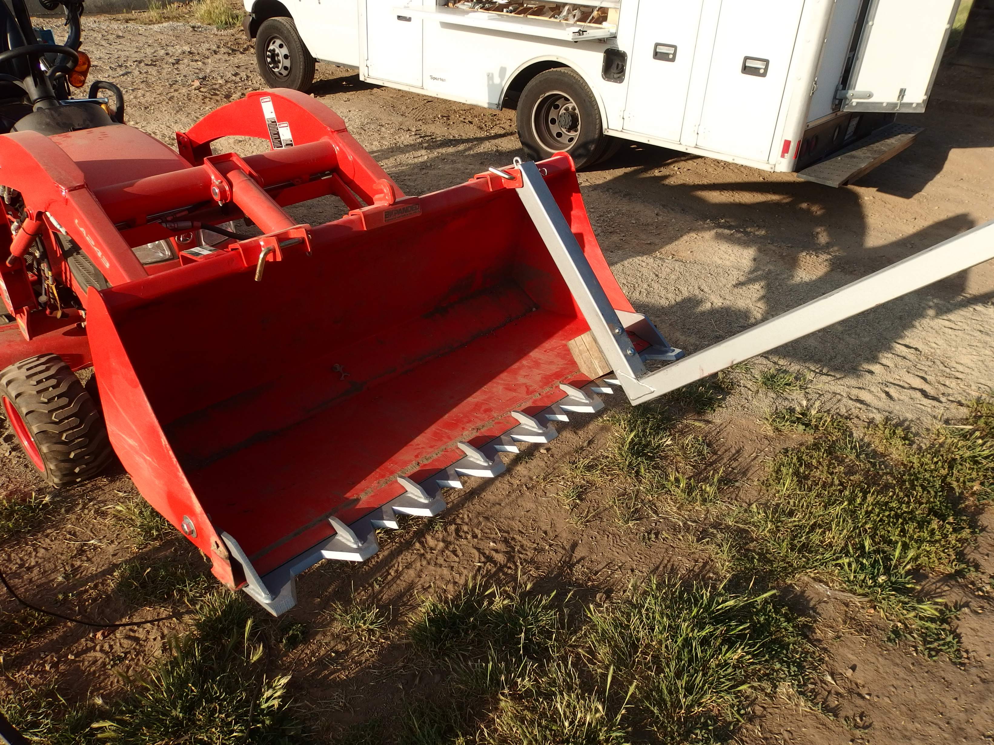

I have the BXpanded forks, and just got the Piranha tooth bar. As many of you know, the tooth bar has cut-outs (teeth missing) on the far left and far right where you can still use the forks when the teeth are installed. However this limits the forks' location. I want to retain the ability to slide the forks wherever I want on the bucket, while still not needing to remove the Piranha.
My solution was pretty simple. Two wood stand-offs screwed into the forks, and cut with a slight angle to fit the lip of my bucket.
This seems to work great, so far.
