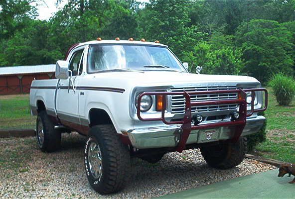

I never thought of the technical or legal reason for having Clearance lights, I just like the way they look, I guess the lights gives off more of a "Big Truck" look, over the past almost 40 years of driving/commuting I've seen all kind of truck lighting, lights in places some folks wouldn't imagine to be, some even have light up tire valve stem caps,:cool: But the Most one common place of all has always been the Cab lights, Here is one of my old dodges with the cab lights I installed, It just seems to add that Big truck look to it,
