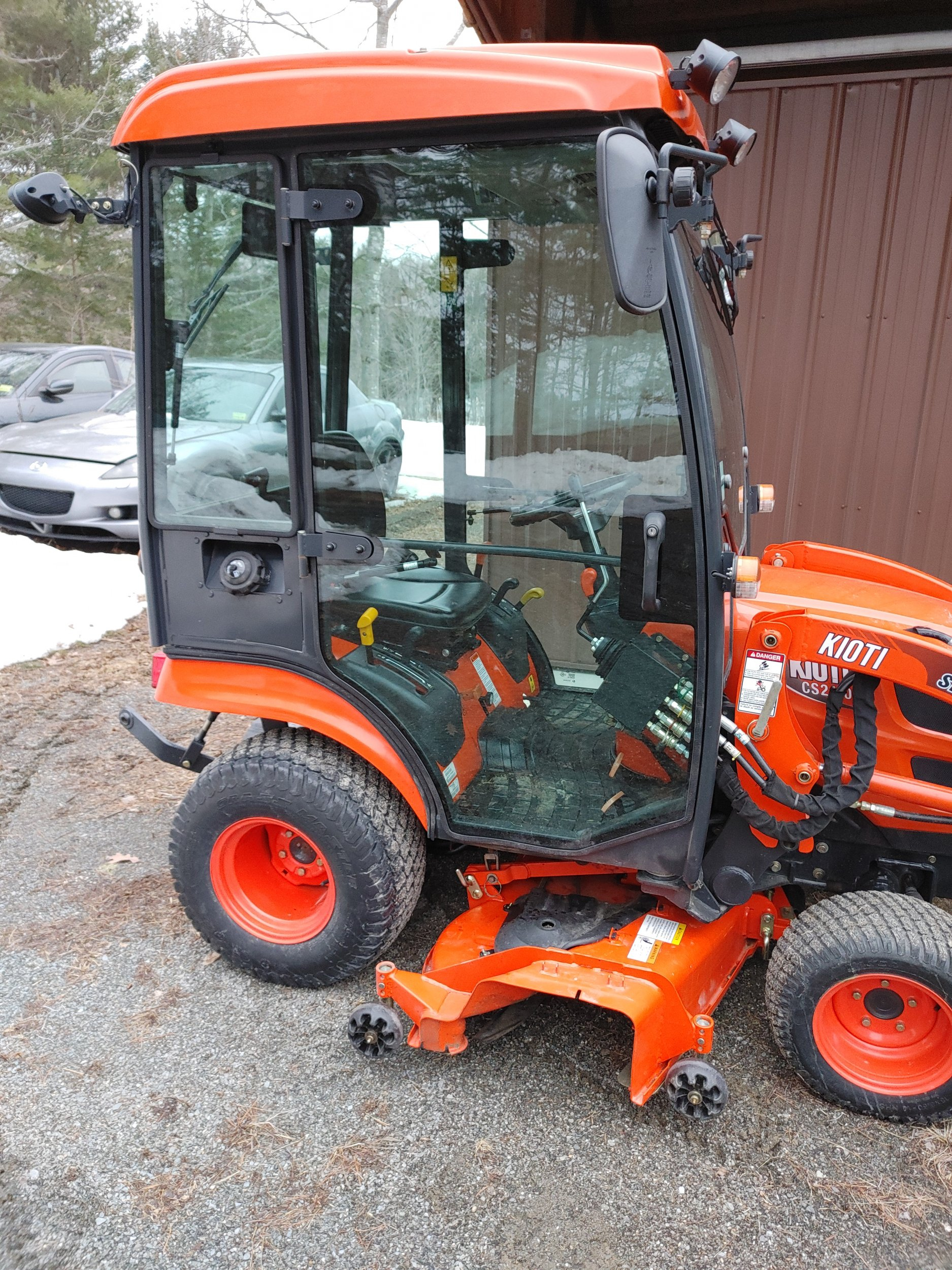

Just picked up a cs2410 with the field cab and plan to mow with it this summer. Since it doesn't have AC I will probably plan to remove the doors and store them off the tractor for the summer. anyone have any good ideas for storage so I don't end up breaking them?
Also I have done many tractor or automotive modifications over the years and would love to retrofit AC if anyone has done something similar.

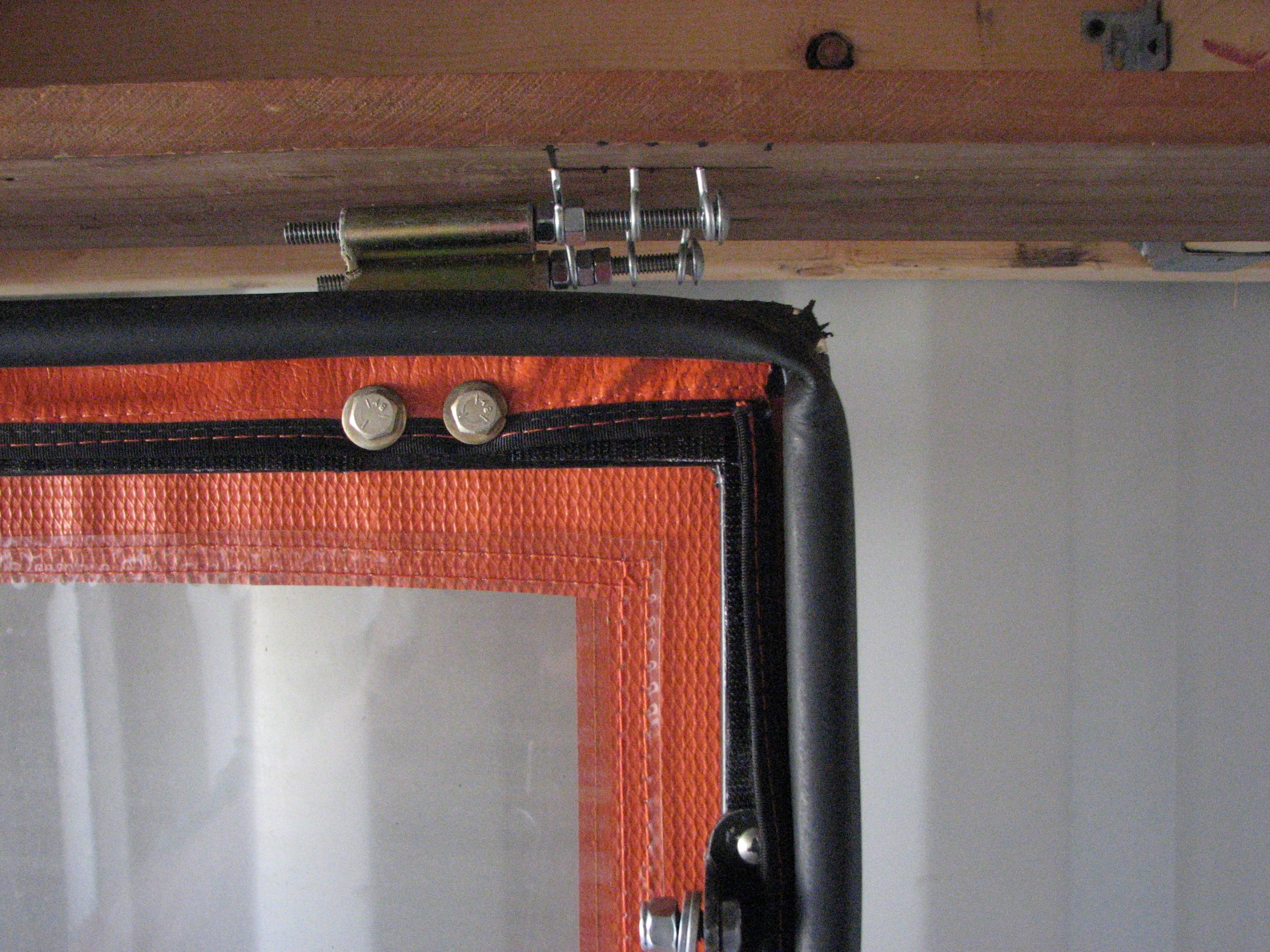

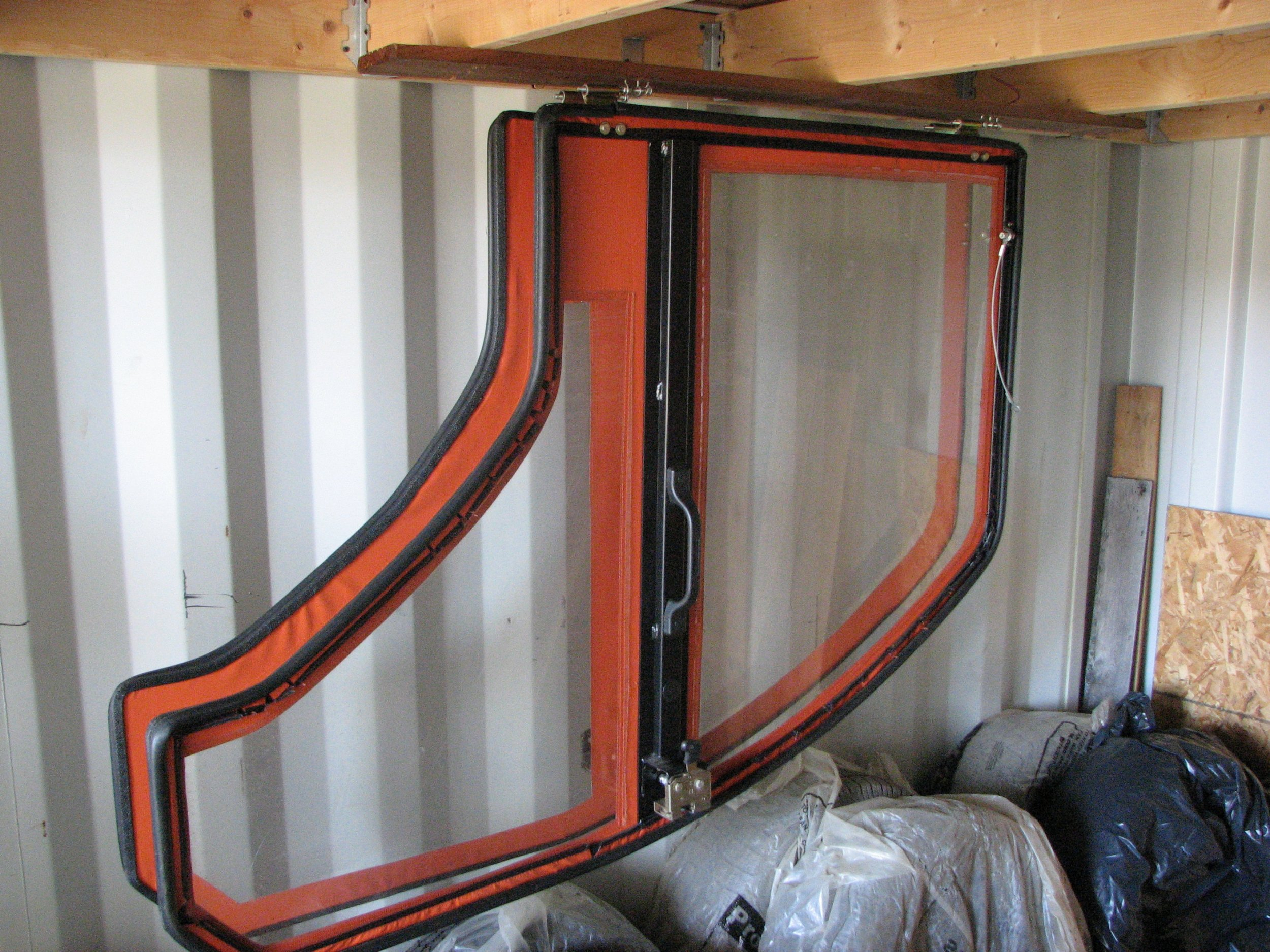

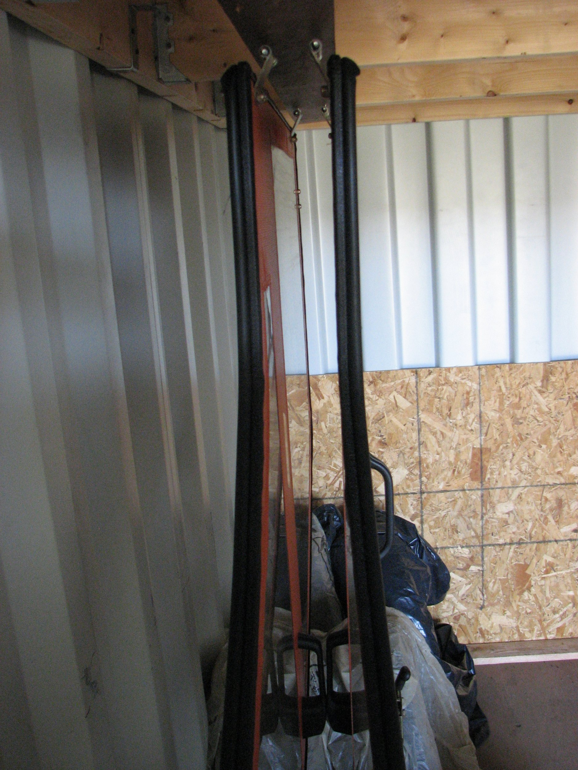

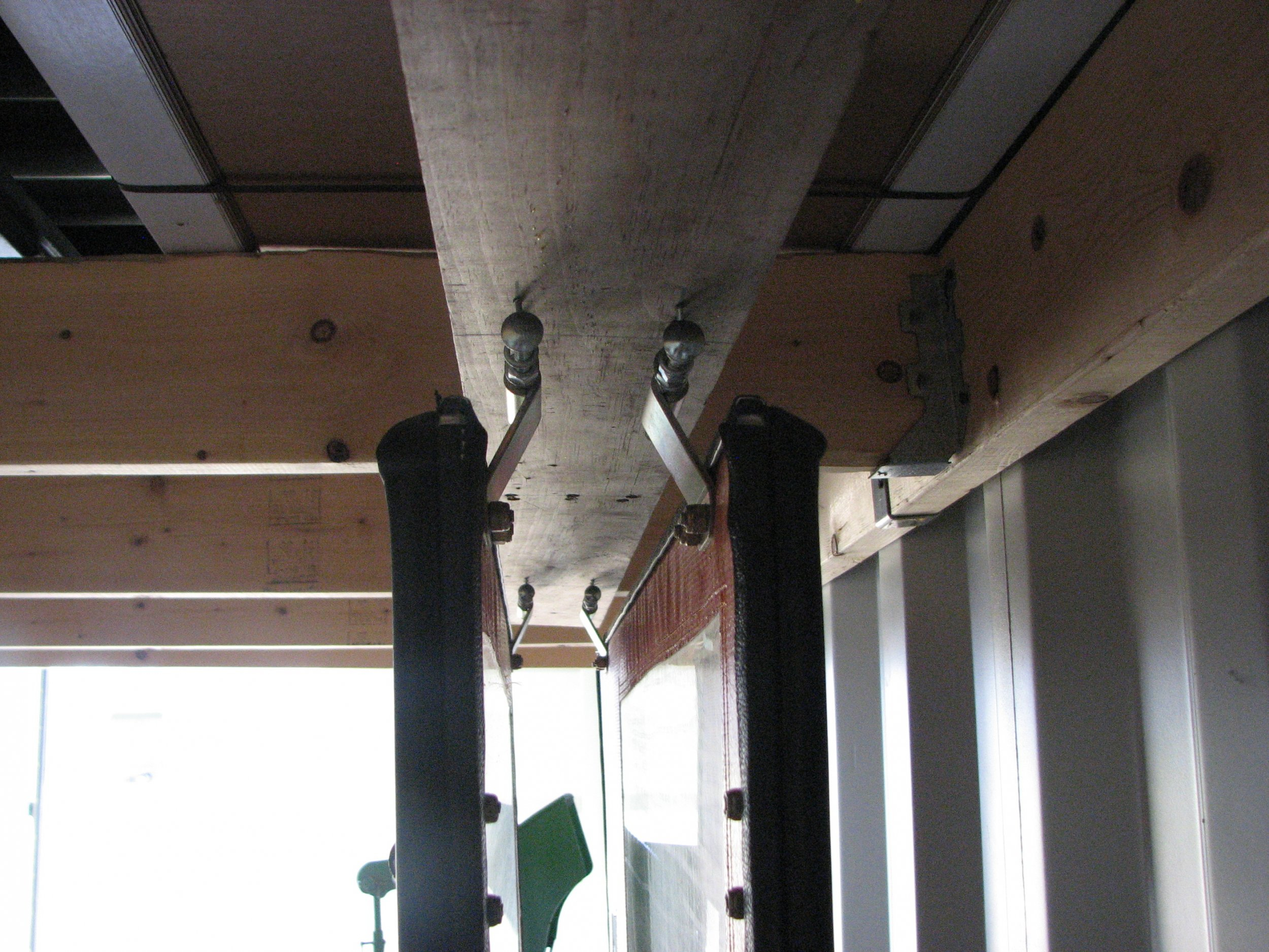

I store my Curtis cab doors by hanging them from their hinges, inside a shipping container.
The doors are not very heavy so each ceiling attachment are just 3 screw in eyelets with a 1/4" dia. bolt and nuts. The door hinge easily slides over the end if the bolt.
The doors are out of the way with very little chance of being damaged and the floor space below can be used to store other items.
