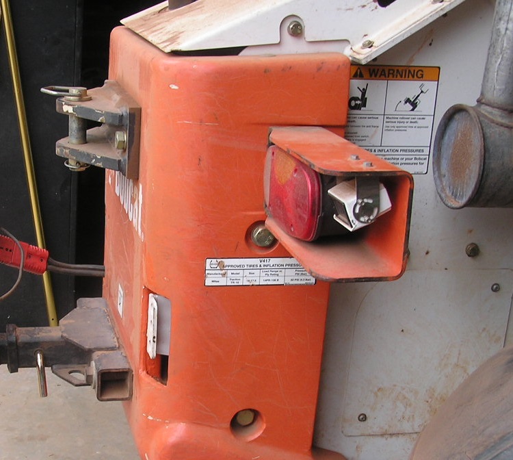

I have a Rearview Systems 7" monitor and two cameras:
Rear 130 degree wide view camera is mounted in the tail light bracket:

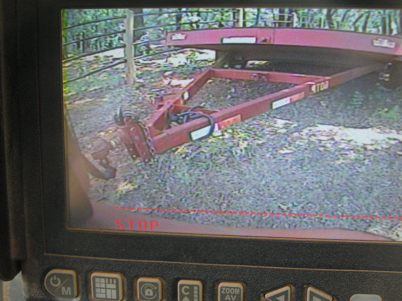

I can see the coupler and back the ball under it:

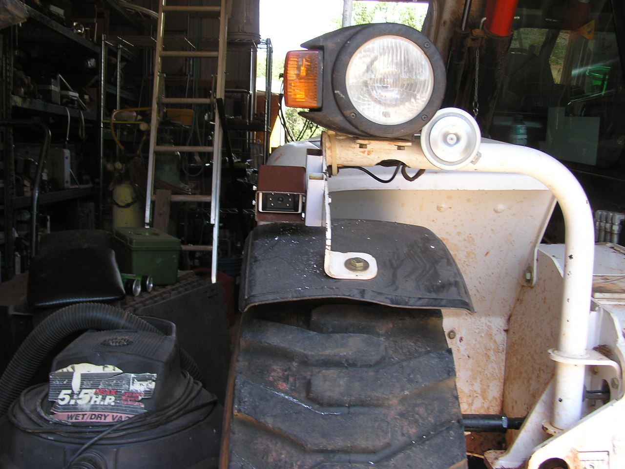

Front 50 degree narrow view camera is mounted over the right front wheel:

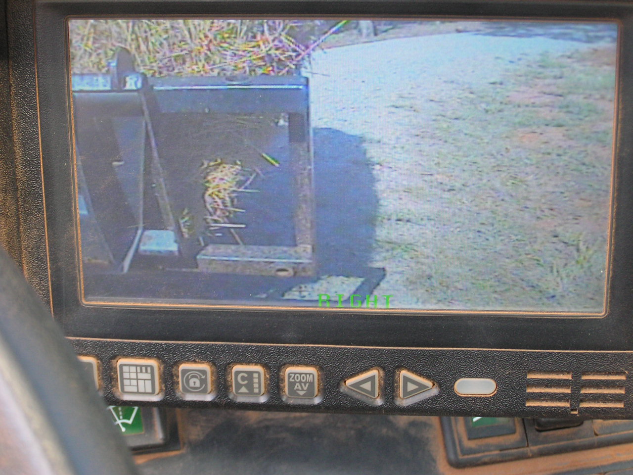

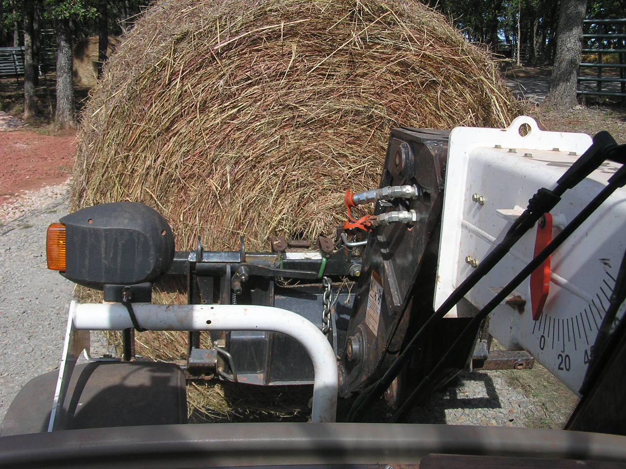

Looking from the seat with a 5x6 round bale on the bale spear:

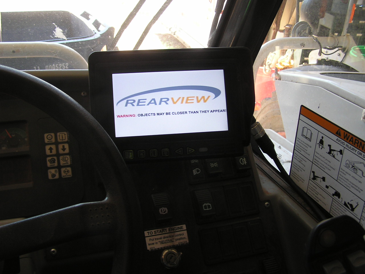

The monitor shows what I can't see out the windshield:
