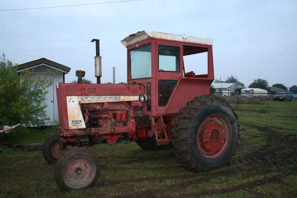

I am looking for a RH door and side window frame for an Excel Cab used on an IH-806 diesel hi sn tractor. I hope I don't have to try and fabricate one. Don't need glass - will replace with plexiglass plastic.

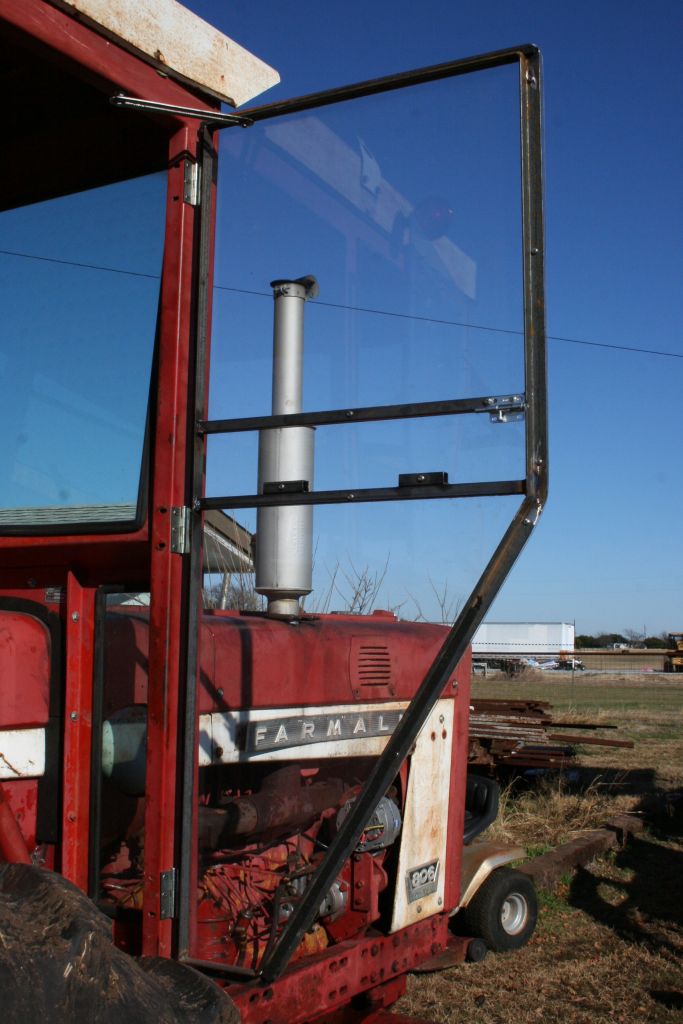

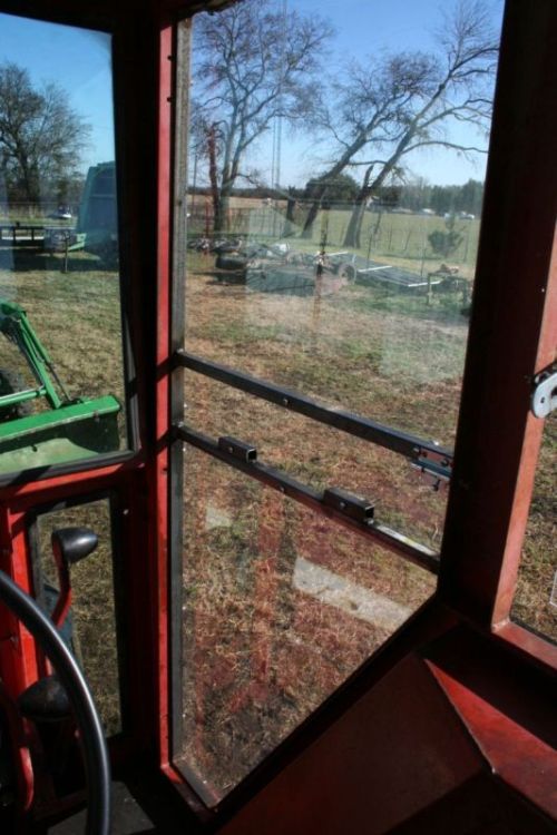

Found a similar cab at a local salavge yard. $600 for a door and side window. $850 for the entire cab - rough condition. I decided to buy some angle iron and plexiglas and make my own door. I like the home made better than the OEM door so will have to build 2. Best regards and Merry Christmas. Steve

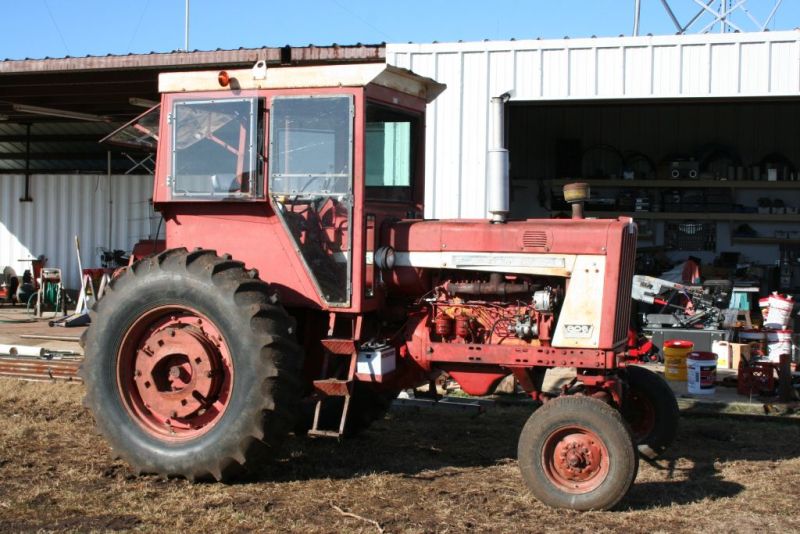

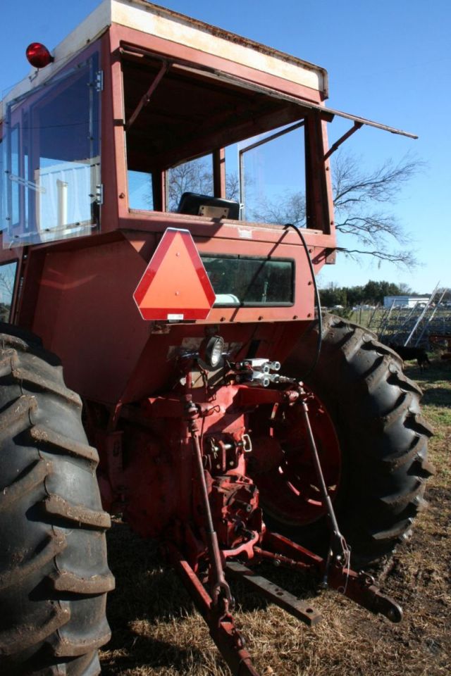

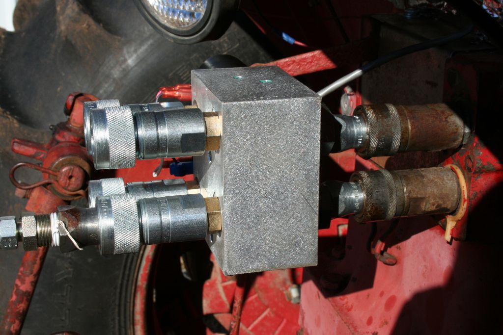

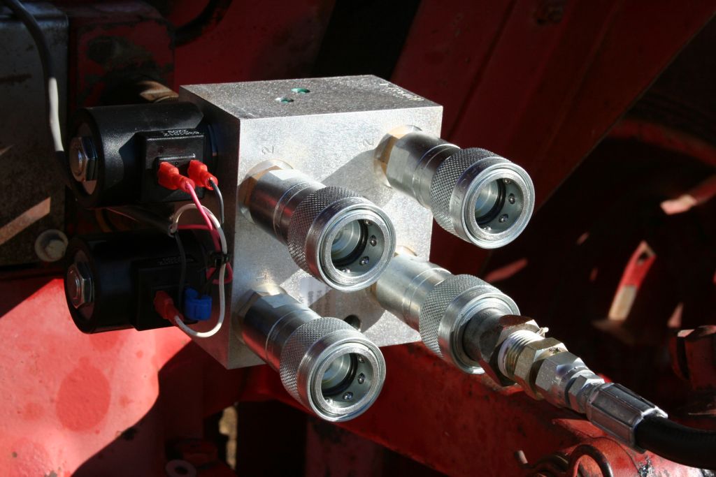

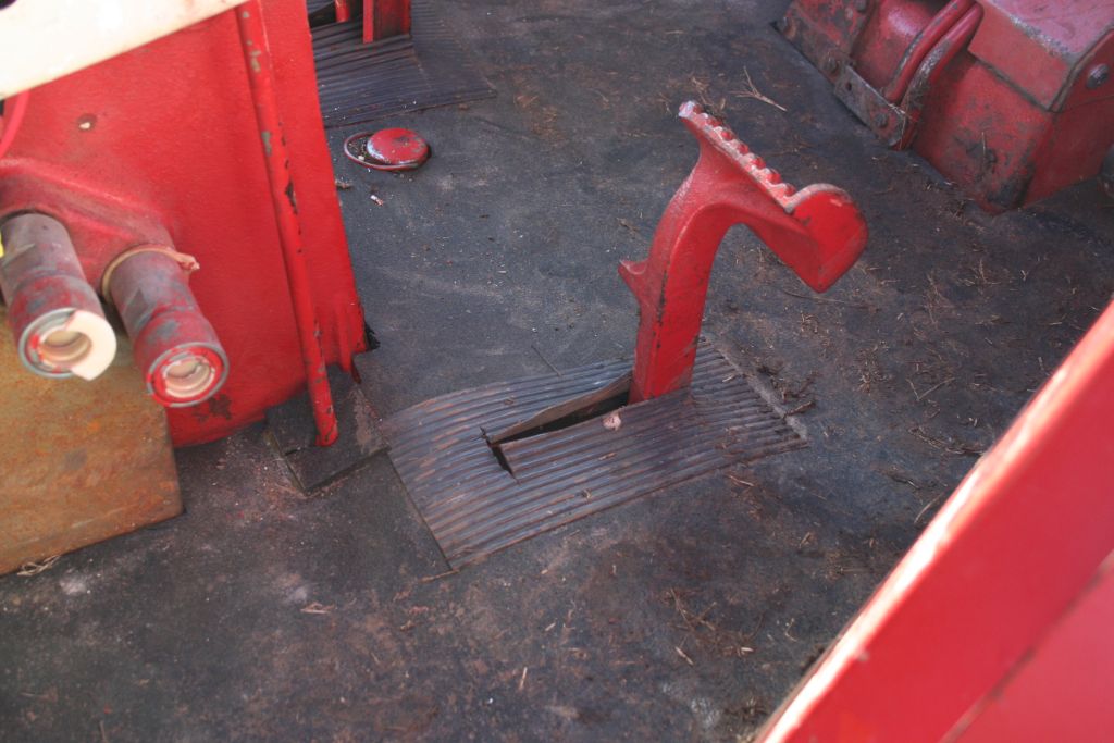

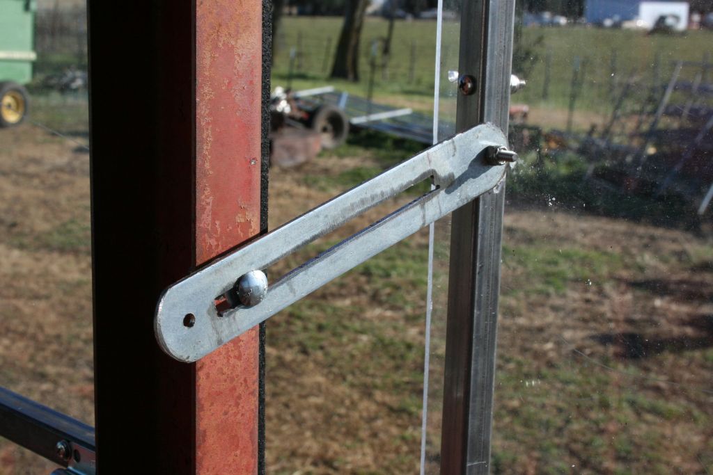

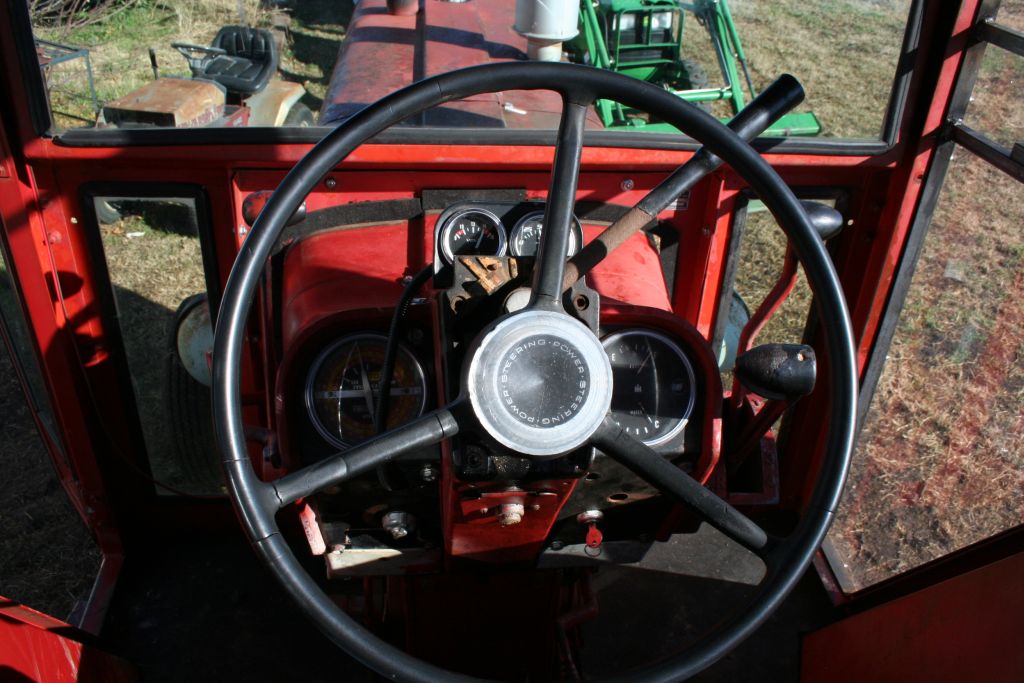

Glad to - The project included a new RH home door and frames for the RH and LH sides with closure hardware and a rear window - all of .220 plexiglass. Also I added an AI hydraulic multiplier, and fashioned a floor mat from 1/4" rubber mat and tool box drawer liner.

Thanks for the photos!!! That a great tractor, a motor with wheels!!! Nice job with the doors and such... professionally done :)
   / Cab Parts- Wanted - Excel Cab RH Door - IH806D hi sn #9
Good job and I'm sure you saved some $$$.
