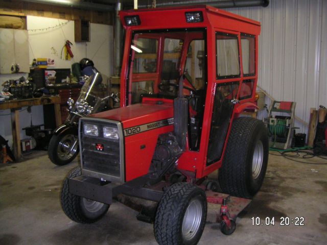

I'm new here but have been browsing around and am very impressed with TBN and all of the informative responses shared here. Just thought I would share my project that kept me out of the house at nights.
I've had a 1020 Massey for several years and decided to build a cab. I'm cheap and did not have the money for factory built.
I used 1" and 2" square tubing for most of it and 1" flat for window and door flanges. 1/4" thick scratch resistant Plexiglas for windows. Was lazy and didn't make windows to open. That prodded me to hanging A/C.
A neighbor had a junked out combine with add on air. He let me have the evaporator, heater core, blower fan and controls for FREE. I found a compressor and electric fan in a junk yard. For the condenser out front I parted out 2 small 110 volt window a/c units. Decided to loop two of them together to be sure I got enough cooling capacity. Glad I did, it works great!
I had to weld and/or braze most of my own fittings as needed. Brother is mechanic and advised me what and where.
Still working on sound proofing. It's pretty noisy inside right now. Mounted the cab on rubber but didn't help much. I guess with a head set and stereo I can adjust to the cool in summer and warm in winter.
My biggest problem now is my hydrostat. Makes a lot of noise and has a loss of power as the oil gets hotter. I posted in the Massey section but have yet to have any response as to where I might send the Hydro unit for rebuild. It's a KAYABA HVFD-23 according to the service manual. Anyone with info or suggestions?

Beautiful cab! How long did it take?

That is a fine looking cab. I would be interested in the pictures. Do you have an pictures of it as you were working on it?

Steve; It was kind of a labor of love. I didn't track time or $ but approx 2 months on cab and all summer on a/c ( finding parts etc)

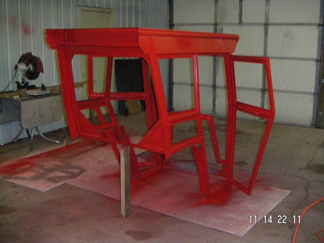

Jerry; Yes I have pictures of framework before mounting it to tractor. Also I did look at the photo gallery but I must be dumber than a box of rocks. Maybe I can talk the wife into figuring it out. I'll do another attachment now.

<font color="blue"> Yes I have pictures of framework before mounting it to tractor. </font>
Great. I would love to see the rest of them. Go ahead and post them here and when you figure the photo section out, put them there.

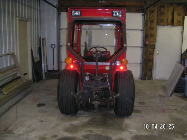

I was able to upload some photos on the gallery. Kind of the main shots. Glad to share.
This the last attachment I can do until I reduce the size some more. I'm just over the max bytes.
