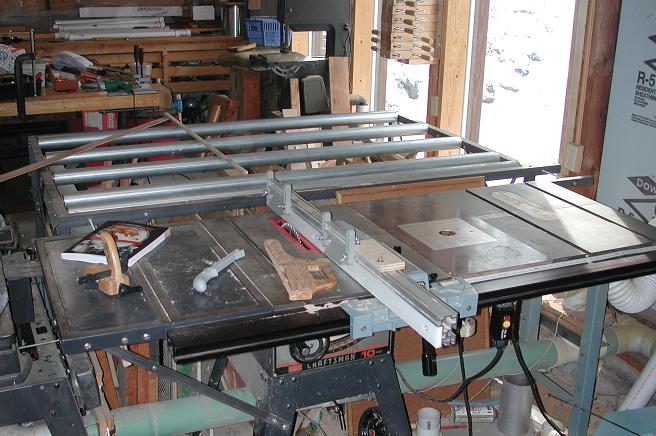

Myself, if the price difference were not an issue, I would go with the higher HP. Not because the higher HP is needed for what you seem to want to do...3HP would probably be more than enough...but because it gives a little more cushion for those unplanned for future things you might want to do, and expecially because the larger motor will have more mass, more cooling area, and run a little easier when you are really working it on a hot day.
When I upgrade I am going to get a 5hp saw, 12" minimum blade size. Mainly because the larger blade size saw often equates to a larger table size, along with thicker cutting ability.
In the meantime, I will continue with the old 10" craftsman setup I have. It has evolved over the years to a very satisfactory setup, considering what it started out as... /forums/images/graemlins/smile.gif
I've attached a photo. I am sort of /forums/images/graemlins/blush.gif that my shop is looking more and more like Junkman's garage... /forums/images/graemlins/shocked.gif

I've got a Delta Unisaw. 3HP is more than enough - I've cut thick hardwood @ 45 degrees and never stalled/thrown a breaker. Of course, you want to run @220 V.
Although 12" is nice, actually getting an assortment of 12" blades is mui $$$, vs 10". Plus, I would bet that a thin kerf 12" blade would wander a fair bit.
Henro's photo shows a good outfeed table. Outfeed and side support can make a huge amount of difference, especially when working with plywood.
