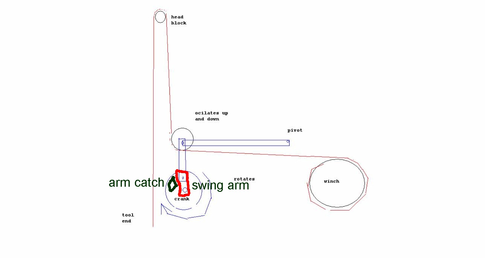

Does anybody know how I can make or obtain a winch suitable for cable (or percussion) well drilling? It would have to hold enough cable to go at least 150 feet. It would need to have some type of free wheeling device with a clutch so that you can winch up the bit 6 feet or so then let it drop.

I don't recall the guys on the one rig I saw using the winch to do the actual drilling. They would send the bit down to the bottom of the hole with the winch, put on the brakes, then start up a second, reciprocating mechanism that would alternately pull on, then let down the cable.

If you look at a good cable rig the winch doesn't wind and unwind for the hammer cycle.
The winch is forward on truck go's 90 around a pulley on an eccentric then to the top of the rig makes a 180 back down to the tool.
the eccentric moves the 90 pulley up and down taking and removing cable to lift the tool and drop it.
Ill try and sketch it up

here is a sketch if it works
http://www.tractorbynet.com/photos/data/500/medium/cable_rig.JPG
There is usually 3 winches one for the tool, one for the bailer, and one for the casing.

I have seen some smaller units that use a break over or swing arm, on the drive wheel instead of a fixed crank,
it is attached at the center of the drive wheel and there is a peg or cleat that will catch it, and rotate it in the same manor as a fixed crank, but when it comes to the down stoke or the cable being released, the arm can swing upward dropping the bit faster, than what the drive is turning,
