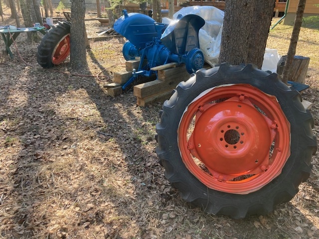

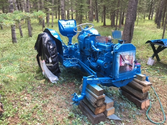

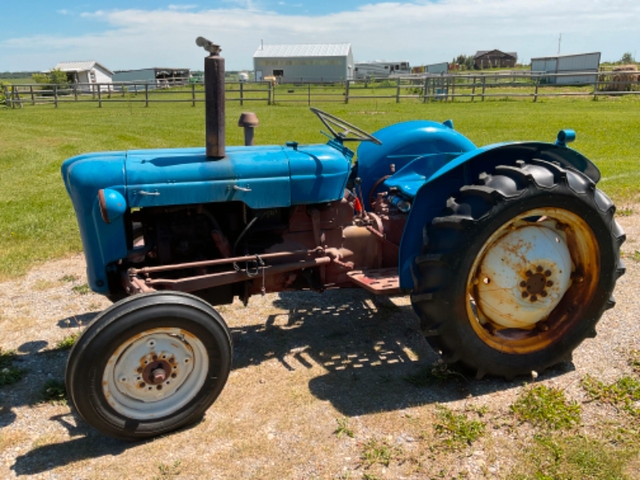

I have a 1959 Fordson Dexta that I have been working on for the last couple years. I use it as acreage tractor doing light odd jobs. I has Ca in the rear tires. One tire has more than the other as it is considerably heavier. I experienced this when I took them off to paint. I am considering having the Ca removed and I have heard that I if I do this I should have the tubes replaced. The other choice is to have the lighter tire with Ca topped up and leave them as they are. I don't really see the need to have the Ca in the tires as not doing any real work with the unit but as I am a relative novice, wondering if this might be a mistake with the handling of the tractor with no ballast. As well, can I just drain the Ca Cl2 into a bucket, get as much out as I can then run it that way? Wondering what the experience says.

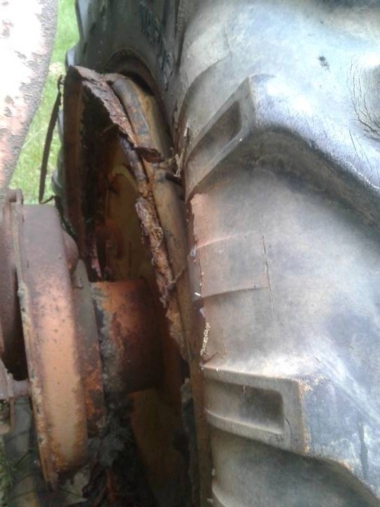

I did a similar project with a 1980's Kubota L185 which had calcium in the rims, but the rims were eaten thru around the valve stems and other areas. So I took the tires off the rims, had them sandblasted patched/welded and put new tubes and no calcium.
IF your rims aren't rusted through or leaking, I would leave "as is" with the ballast you have in them today - once you open the valve and add more or take any out, it may continue to leak. Plus you have primed them now and if no big holes in the rims - just run it until you need to replace the tires.

When the tube starts leaking, the highly corrosive salt will rust out the rims. I would drain the fluid, remove the tires, clean tire & rim. Rim may need to be repainted before remounting tires with new tubes.
Thanks for the advice and experience. I talked to a tire shop and got the same advice. If they are not leaking, leave them alone until they need to be worked on. They advised that attempting to add or drain fluid could likely result in needing to do additional work. Their advice - don't touch them until you need to then be prepared for rim work and potentially some time up on blocks.
Thanks again
