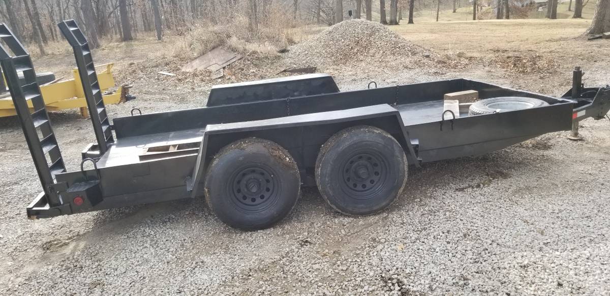

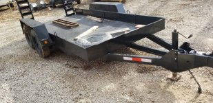

This trailer would perfectly fit my needs - hauling my tractor and with the lip that goes all the way around I could also haul some gravel. If you know the style or better yet, the make or model I would greatly appreciate it. :thumbsup:

Looks like some home made additions on that trailer........

Wow, that was fast. Thank you!
It was on CL for 2k and I just missed it.

Many trailer makers made that type of trailer. The angle lip adds strength so the trailer can sit slightly lower. It also allows gravel, mulch, or firewood to be held on the deck but makes side loading with forks difficult. Some call it a "pan" style too.

Perfect, thank you!

My Dunn-Rite was setup like that. I despised it. Can't load anything over the sides without stacking pallets underneath or what not. Its stronger & makes for a lower potential deck height. But for me, it wasnt worth it. It was way to short for me & improperly balanced empty, which contributed to my dislike. Loved the low deck height & load angle though. It was a hella stout trailer, great for a skid steer or mini-ex I expect. Less so for a longer though lighter tractor.
I ended up with a power tilt deckover rather than another gravity tilt. Harder (steeper) to load a tractor on, but way easier for any other stuff.
