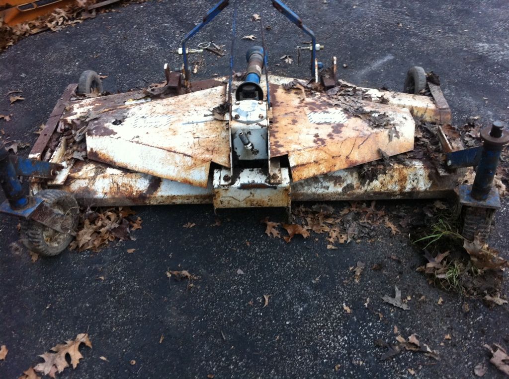

I got this 54" finish mower with my Satoh S370D when I bought it. My tractor has the oddball CCW pto.
I'm trying to find some info out about it to see if I can fix it up and use it. Someone did some modifying to it to make it fit the cat 0 on the tractor. I haven't found any tags or decals on it.
   / Can anyone identify this 54" finish mower? #2
Looks to me like a Ford 930A with cobbed up front wheels. True width of cut will be 48 or 60 inches unless you really blew it and it is a 72" model.
Total overall width is 56". It has three 18" blades. I would assume that would be a 54" cut....
   / Can anyone identify this 54" finish mower? #4
How are the blades mounted. Is there 2 bolts in a diagonal line? If so, it may be a Sun-mastr. They were purchased by Arts-Way (Art's Way Manufacturing - Home) or 712-864-3131. :thumbsup:

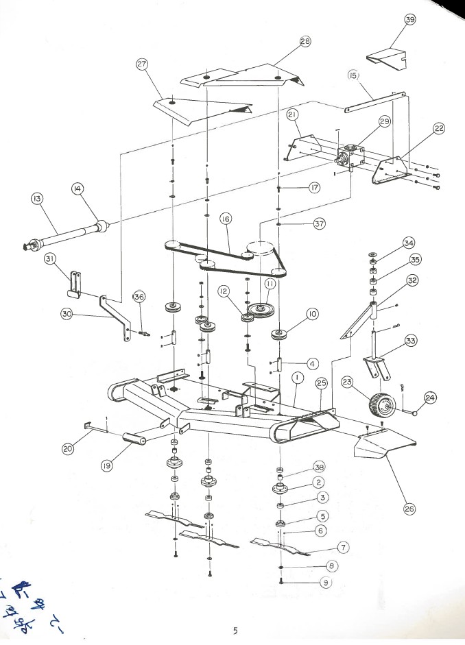

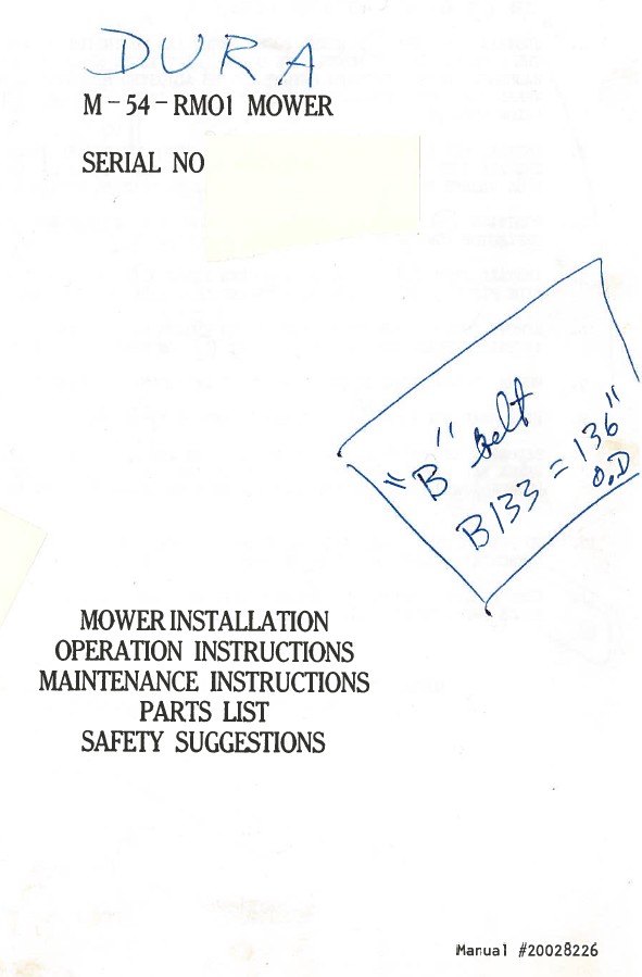

I just bought one just like this. On the manual the first owner wrote DURA and then the manual has M-54-RM01 MOWER. Manual number is 20028226, I can scan and send it to you if you would like. It does have an exploded view with the part numbers for the deck and parts (does not cover 3pt). bearing numbers are 20028043 qty 6, bolts that hold the blades on are LH. shafts number is 80028045. If you find a place for parts please post! Diagram I have does not show front wheels only two in back.

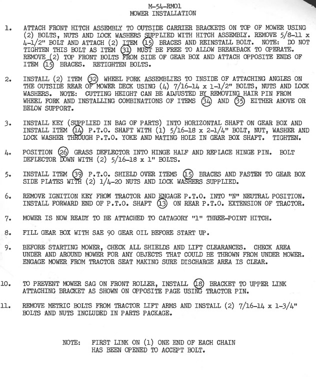

Not sure if this going to work but I took screen shots of the manual. I have the whole manual in a PDF if someone knows how to post it or wants it.
Dura mower exploded part view.jpgDura mower installation Page.jpgDura mower Manual Cover Page.jpgDura mower Part numbers.jpg
