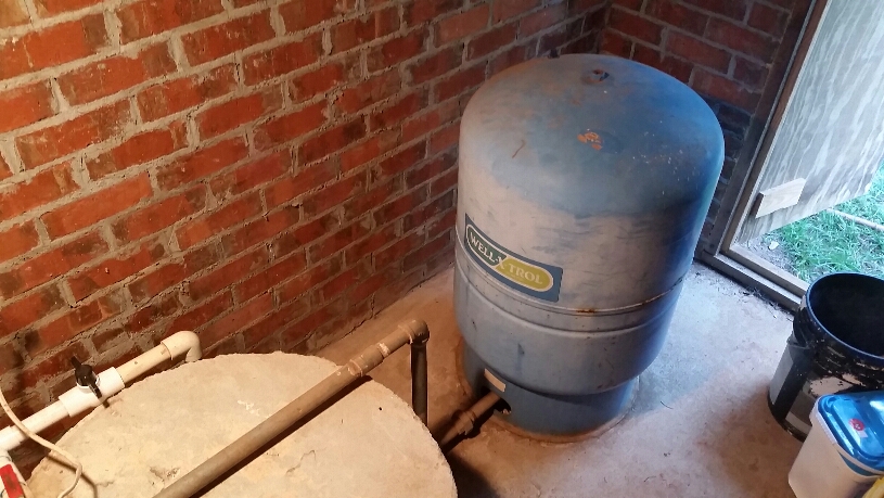

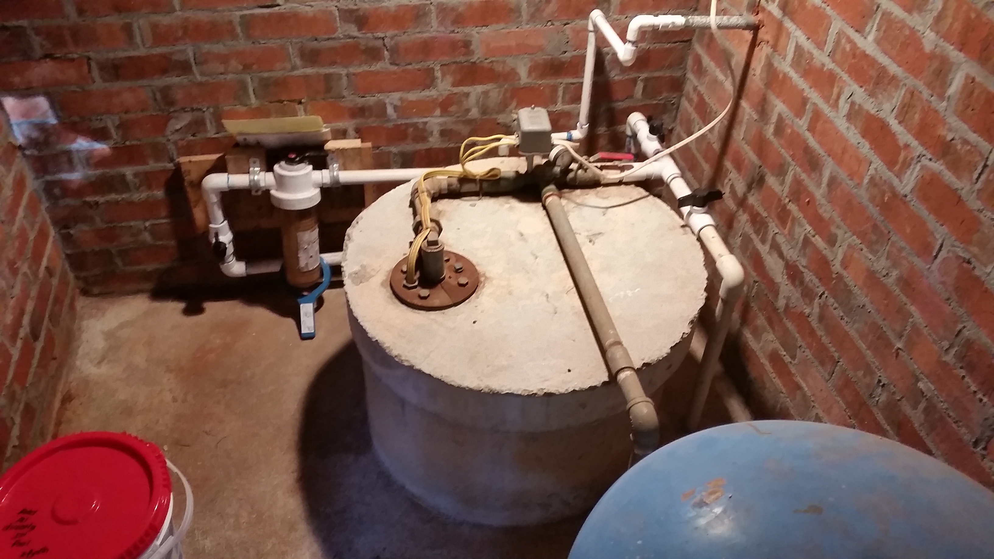

Can anyone tell if this well is bored or drilled by looking at this pic?

There is absolutely no info plaque or paperwork. The home was built in 1994. It has 220 volts / 20 amp circuit.

I talked to someone about this well and he said that I'd have to remove the cap and look inside to know for sure but he was a manager with perhaps limited knowledge. I can do that but it looks like a bit of work to disassemble and then rebuild the PVC parts..
   / Can anyone tell if this well is bored or drilled by looking at this pic? #3
It may be a bored shallow well with a submersible pump. ??
But only a visual inspection will tell you.
If you pull the plug on the fitting comming out the casing and drop a line down the depth may be an indication.

THIS. Since boring and drilling have the same meaning, I'll assume OP meant dug or drilled.... It looks like a dug well, although a bit small on the diameter. Could have been drilled with a bucket auger to a shallow depth. The surface completion looks neat and tidy though.
As Egon said, remove the sounding plug on the seal cap and drop a weighted line down to check depth. If you're careful on the way down, you can hear the "plunk" when the weight hits the water. Mark that depth and then keep going till the line goes slack and that will be the total depth. The difference is the amount of water column you have to work with inside the well.
What exactly concerns you about the well? Does it make a difference to you if it was drilled or dug?

In well terminology there is a difference between boring and drilling. Quite different equipment and methods will be used as well as the depths can be significantly different.
A dug well is a different method completely.

The picture gives mixed information. The well cap would indicate a drilled well of some type. The large concrete casing - some other method of construction.
Be careful dropping weights on strings down the steel casing. You very likely have a submersible pump down at some depth and a weight on a string could become lodged between the casing and the pump.
I would contact your local Health Dept and see if they have records of your well. The Health Dept may recommend other agencies with pertinent information.

Just looking at your picture I would guess that you have a bored well;
View attachment 521292 I tried to attach a image of a bored well and it didn't work well Search for shallow bored water well.
A bored well is the modern equivalent of a dug well, normally done with an large auger, than lined with a casing of some type.
