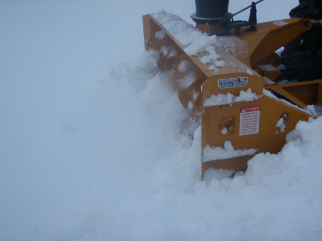

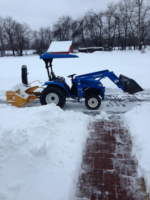

I don't see any issue with it running a 60". I run a 72" on my TC25D. The only difference is I have a hydro trans and yours is gear. You need to find the right gear for the storm and may need to work the clutch in real heavy snow.
Forgot to add I have 20 pto hp.
