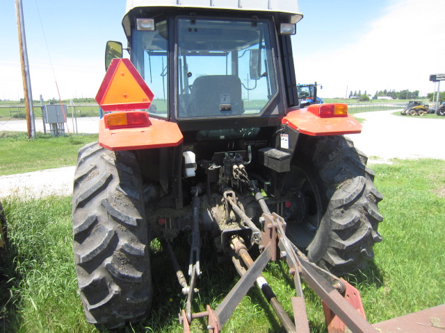

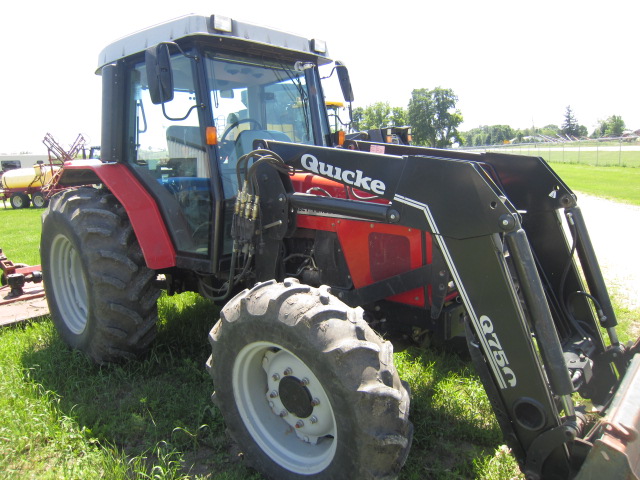

Can I adjust the wheel stance to create a narrower stance without negatively affecting anything? I assume I can switch sides with the wheels to do this? Will I affect turn radius on the front if I do this?

Tractors are mostly made to have adjustable wheel widths for different tasks. The quote "without negatively affecting anything" needs to be quantified. Will there be any physical harm from the adjustment. Absolutely not if you take the right precautions. The rears are most likely loaded and very very heavy. 800-1000lbs+ would be typical. But your stability will be noticeably less if your working on any slopes and be more cautious doing loader work.

I am not working on slopes, I am in the woods a lot and width, or lack of it, means a lot. I don't want to lose turn radius or negatively affect the tractor. The tires are loaded and I realize they are very heavy.

I have the tractor in the photos
   / Can I adjust the wheel stance? #6
It looks like the wheels can be moved to the opposite sides to widen or narrow the width

That tractor has multiple adjustment widths on the wheels via the two piece rim design. You should be able to narrow it up quite a bit.
